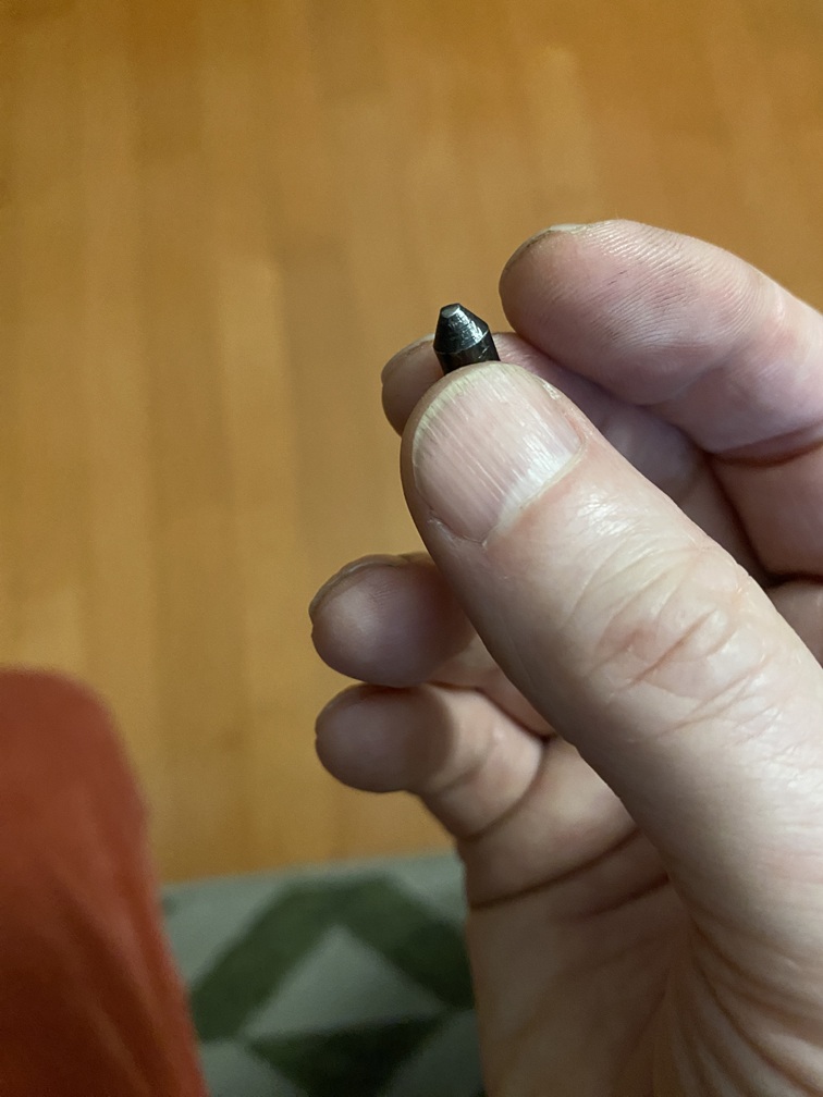

Back in 2019, the trigger guard came loose while firing only the 60th round through the new-to-me 1970 P64. I did not recover the trigger guard pin, but presumed it snapped. Though, when I installed the new pin, I was surprised by how worn the plunger was. See image 4305. Fortunately, I purchased a new plunger and spring along with the pin.

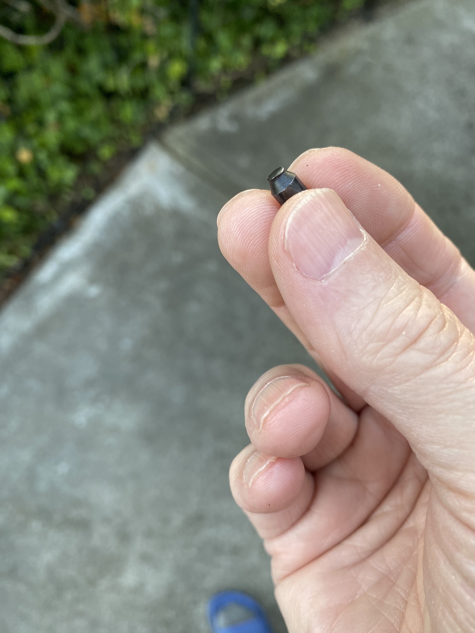

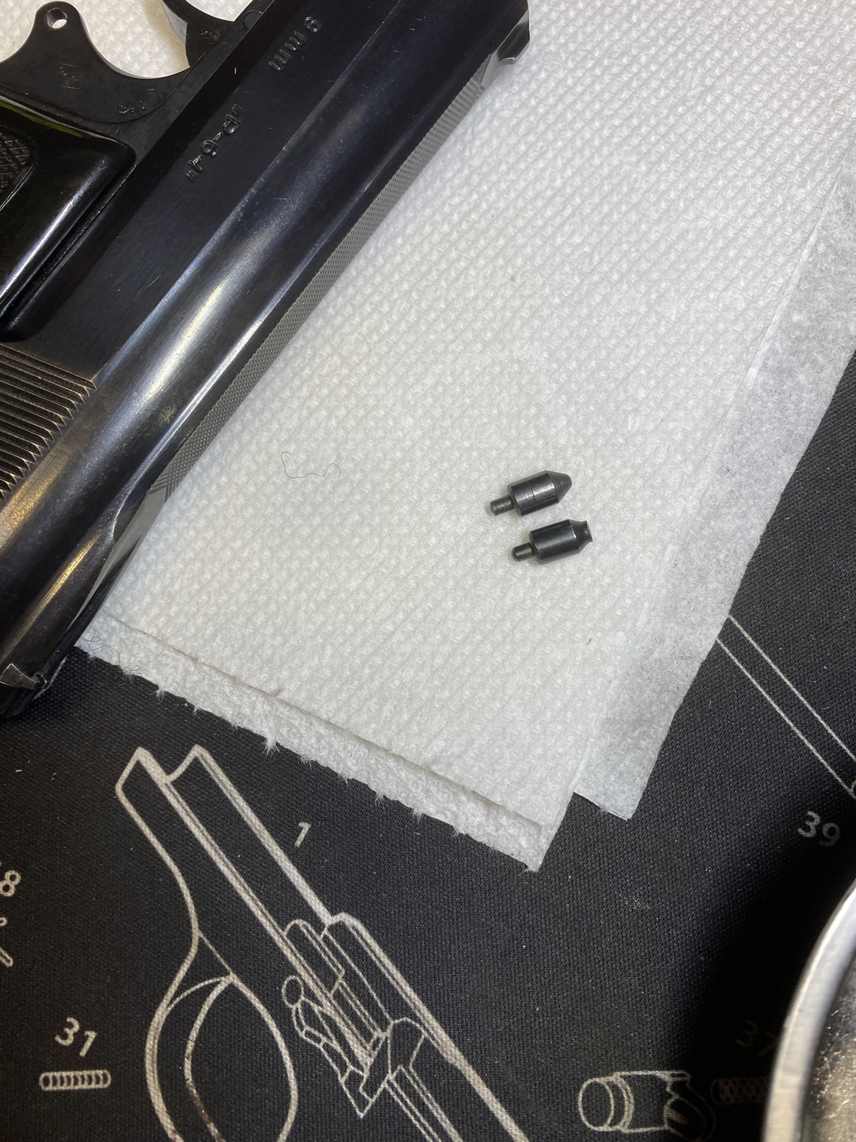

When I got home, I found the plunger was worn even worse than the 1970's plunger. See image 4277, next to a new plunger. In retrospect, it's a good thing my efforts to push the pin back in at the range wound up causing the pin to fall all the way out. Otherwise, I wouldn't have had an opportunity to inspect the plunger.
I ordered a second plunger and pin back in 2019, which are now installed in the 1971.
My hypothesis: plunger wear is what leads to the trigger guard pin falling out or becoming loose enough to shear.

A couple more photos showing the extent to which the plunger has been peened.

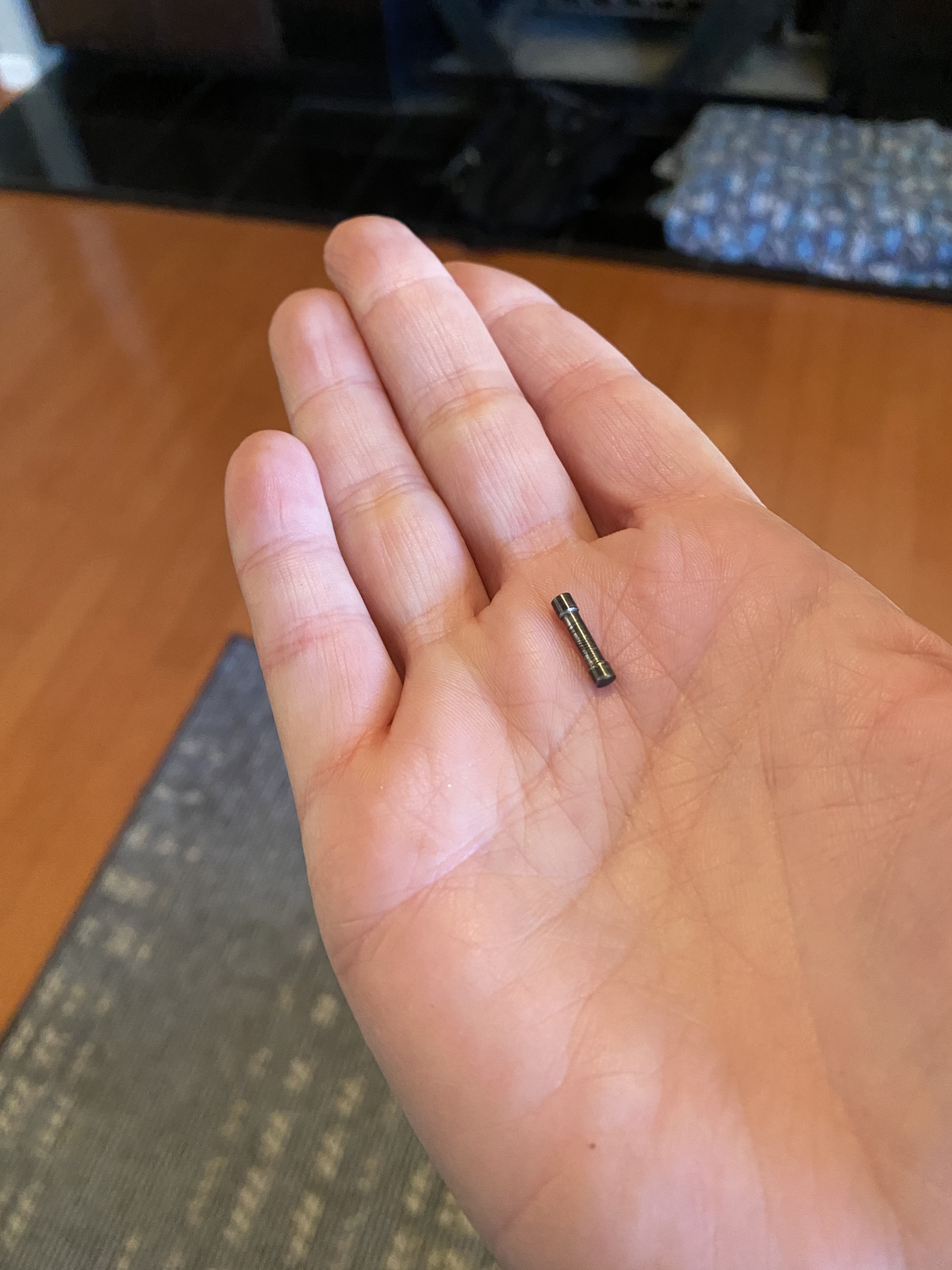

FWIW, the trigger guard pin on my 1971 had little to no wear. So, in this case, it wasn't pin wear that caused the trigger guard to come loose.

I've attached a photo of the pin that came loose from my 1971 P64. Dimensionally essentially the same as a new pin. I was surprised to find it in such good condition.

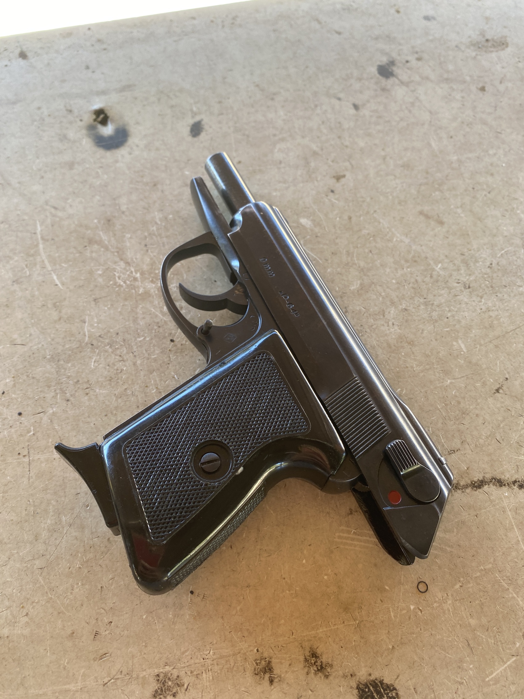

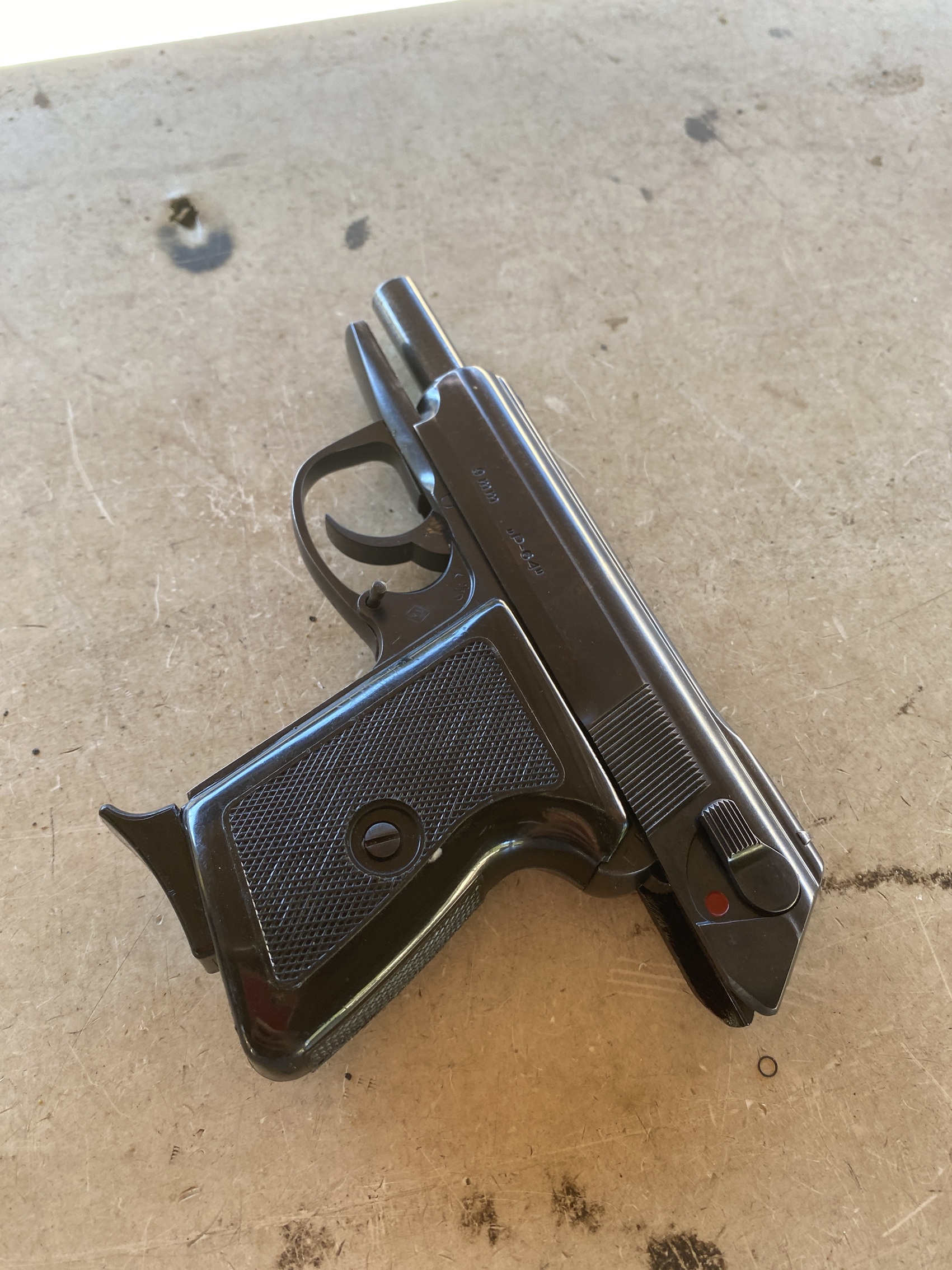

I've also attached a photo of the pistol when I first noticed the pin was falling out.
