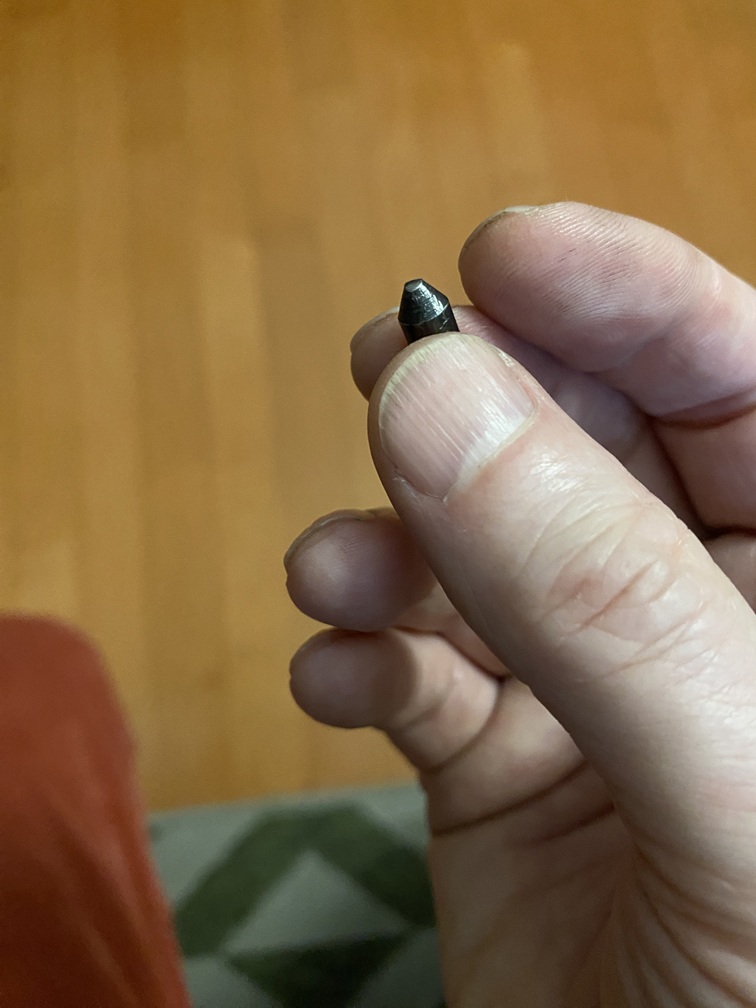

Back in 2019, the trigger guard came loose while firing only the 60th round through the new-to-me 1970 P64. I did not recover the trigger guard pin, but presumed it snapped. Though, when I installed the new pin, I was surprised by how worn the plunger was. See image 4305. Fortunately, I purchased a new plunger and spring along with the pin.

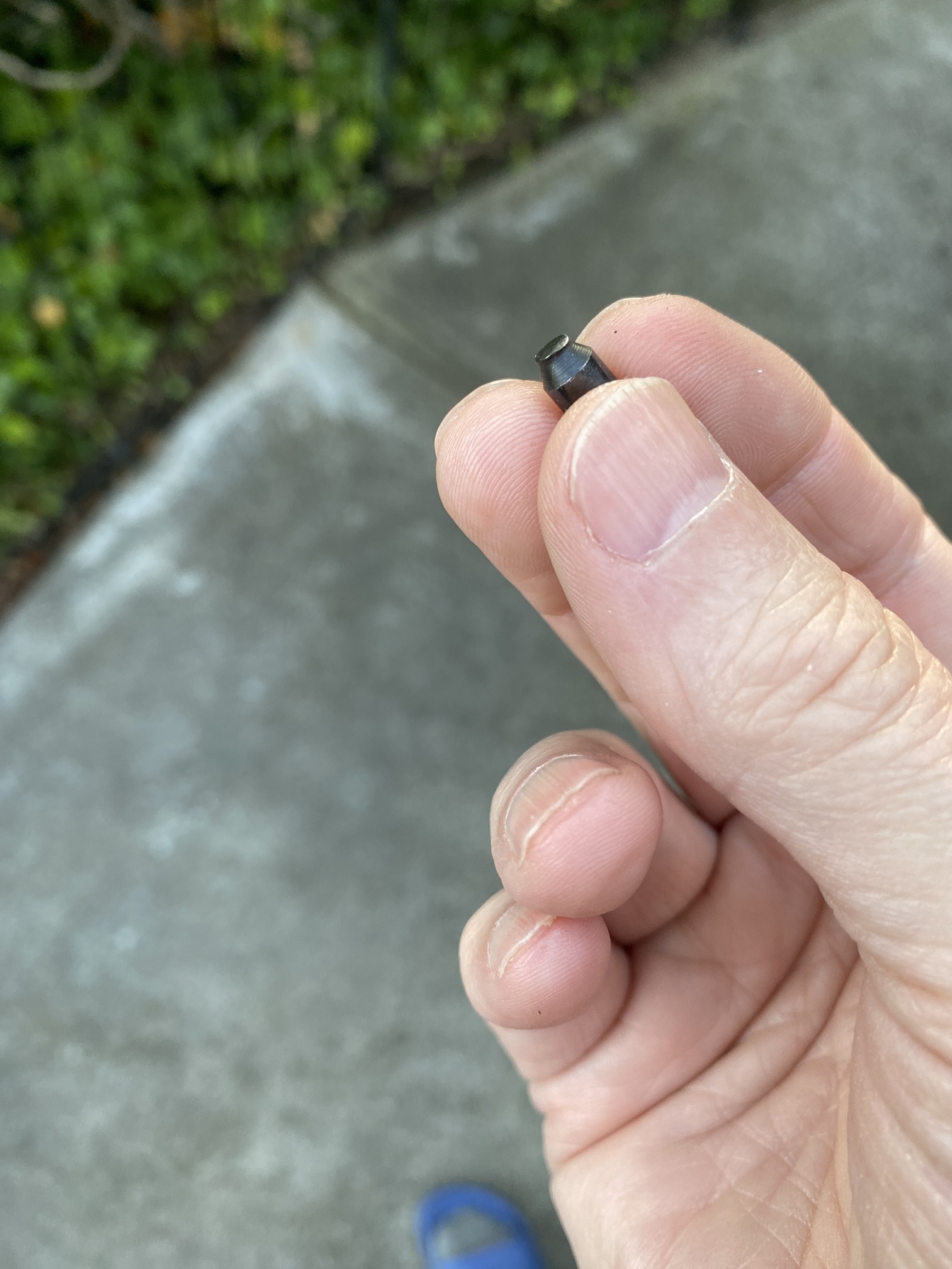

After putting the slide back on, I fired 17 malfunction-free rounds before noticing the trigger guard pin was half way out.

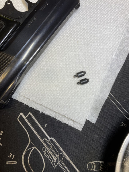

When I got home, I found the plunger was worn even worse than the 1970's plunger. See image 4277, next to a new plunger. In retrospect, it's a good thing my efforts to push the pin back in at the range wound up causing the pin to fall all the way out. Otherwise, I wouldn't have had an opportunity to inspect the plunger.
I ordered a second plunger and pin back in 2019, which are now installed in the 1971.
My hypothesis: plunger wear is what leads to the trigger guard pin falling out or becoming loose enough to shear.
