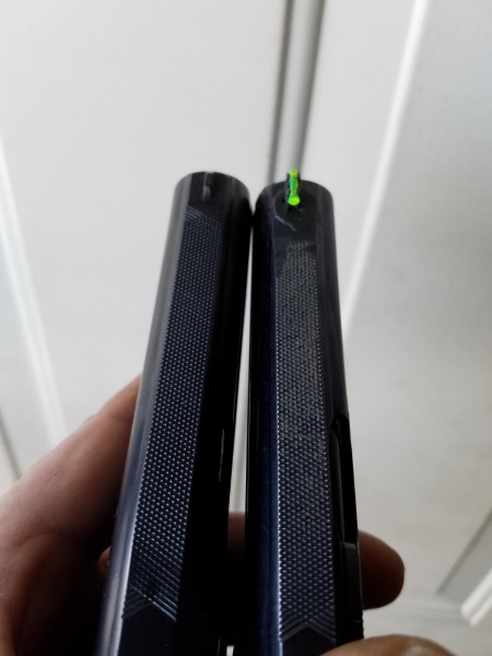

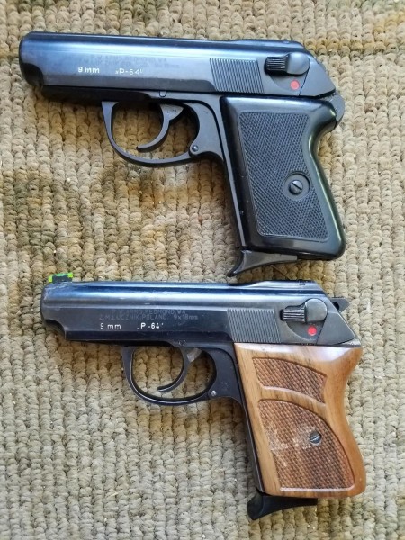

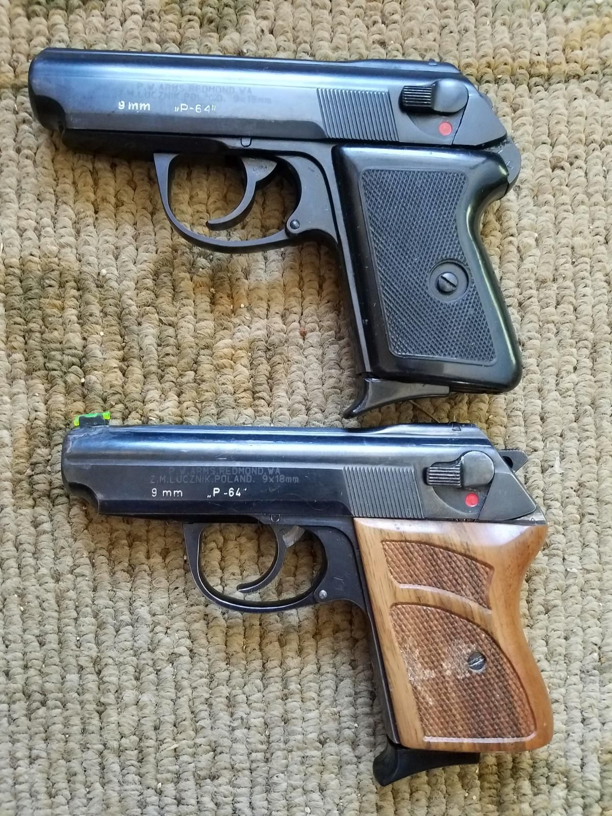

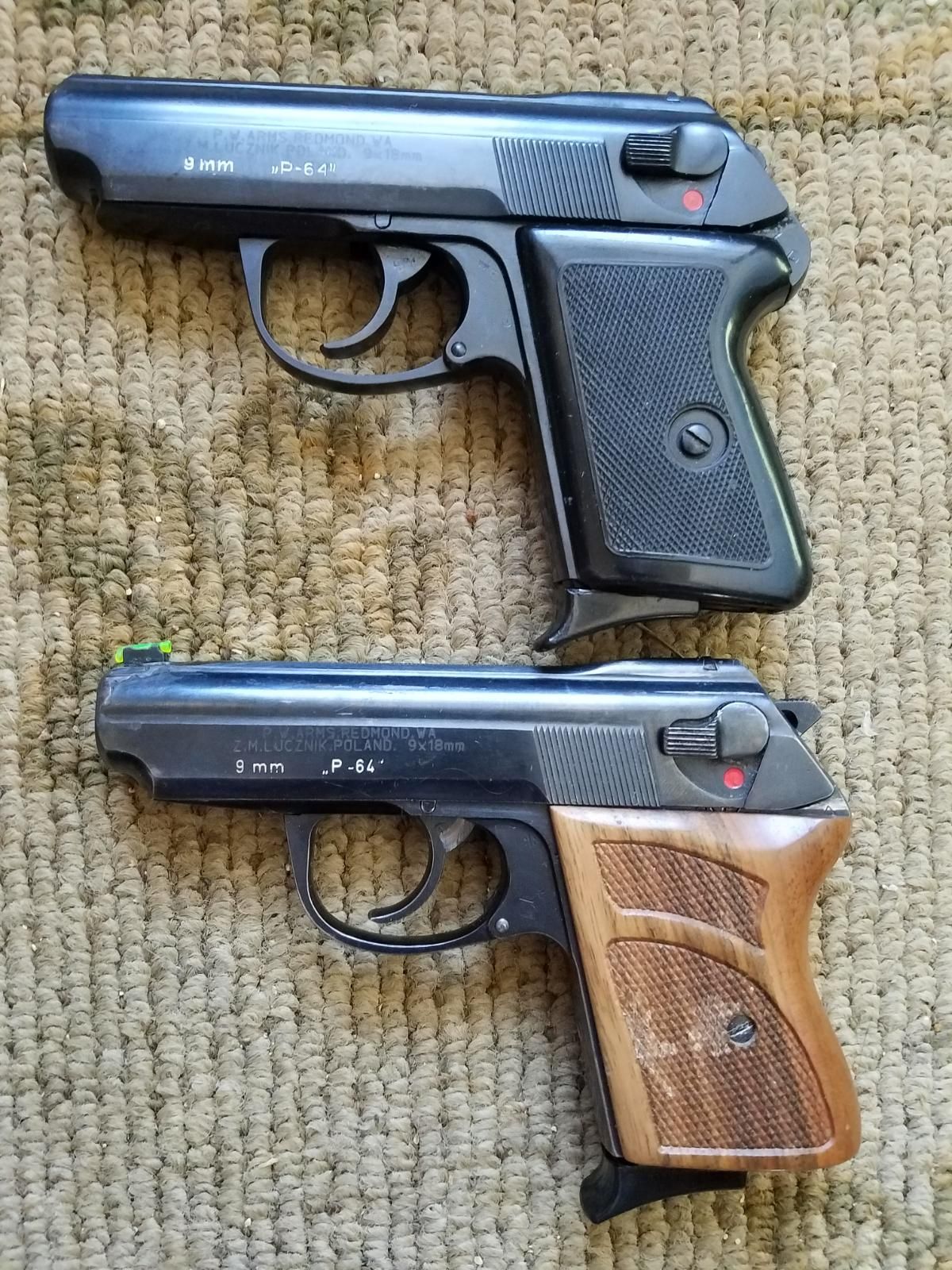

The factory sight on my P64s is so 20th century that being part Bubba I decided to modernize one of mine.
I removed the factory front sight and installed a Hi Viz Spark III fiber optic sight. The colors of the sight can be easily changed if so desired. I changed the grips to wooden ones, I also lightened the trigger spring and I have an extended magazine release I will put in later.

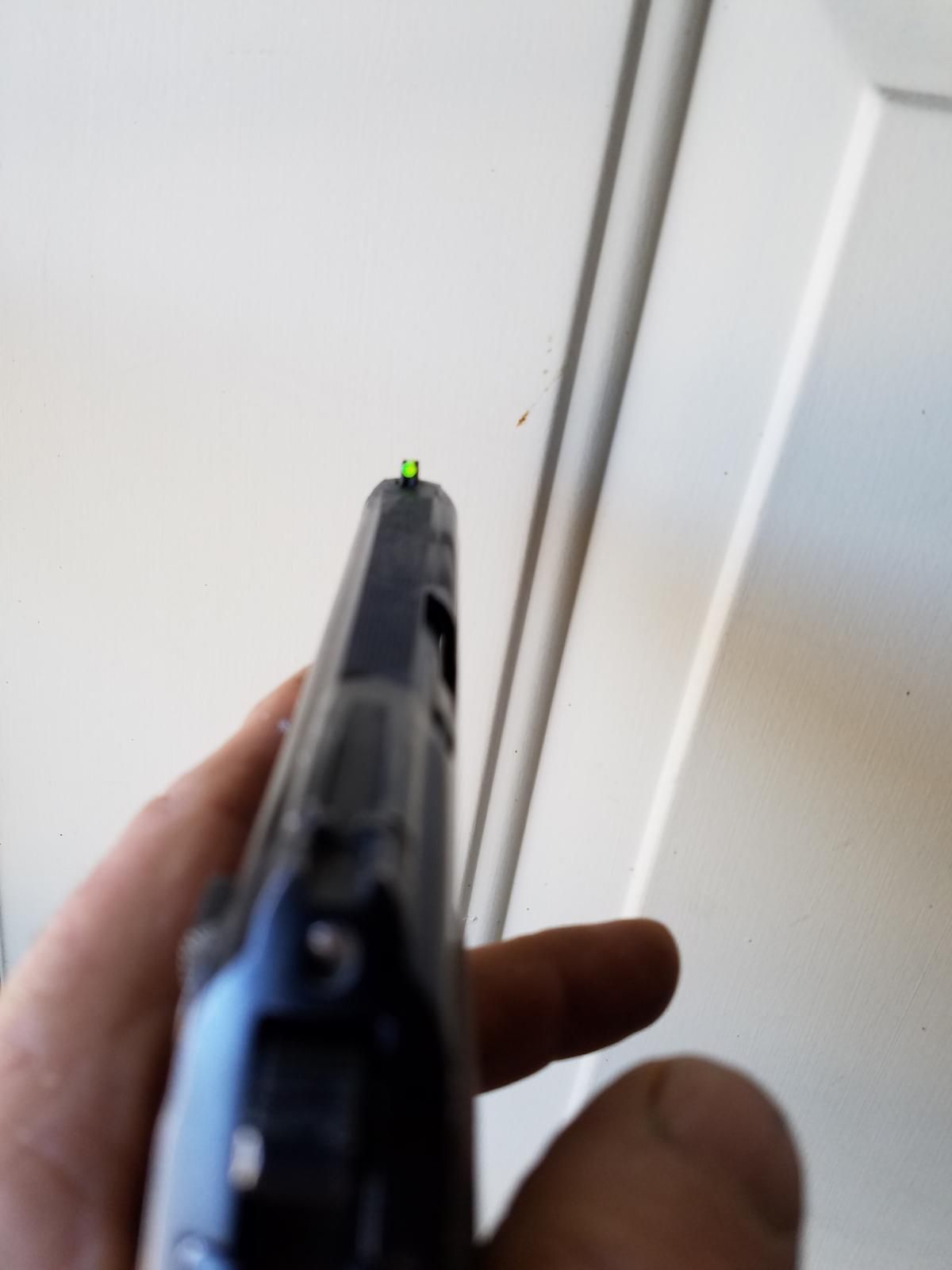

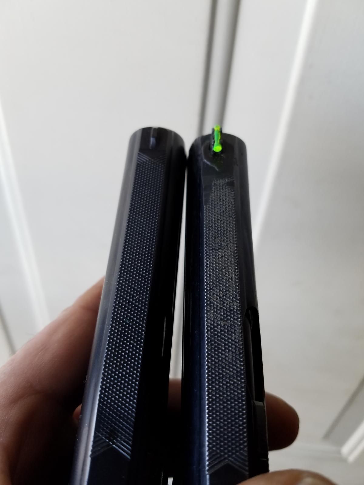

Perhaps it is the camera angles, but is it slightly left of center?
Re: Front sight replacement
It is camera angle.

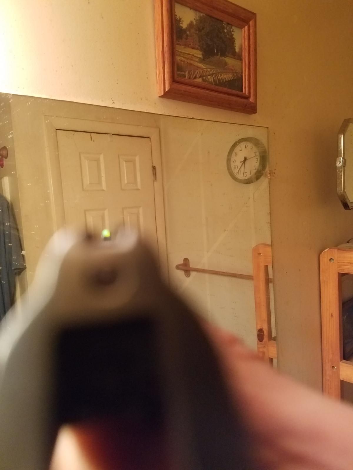

Regarding a change of the rear sight, I had initially considered altering or replacing the rear sight. I had an expectation the greater width of the front sight vs the original notch of the rear sight would cause an issue. I was thinking in terms of running a needle file through the rear sight notch to widen it, or simply replace the rear sight, however, at practical combat range, 5 - 15 yards that Hi Viz sight is really noticeable (see sight picture photo above) and I see no point to doing anything to the rear sight. For whatever reason on my pistol, with the new sight, at the ranges mentioned the bullet impacts close enough to what the front sight is covering that I see no issues.
