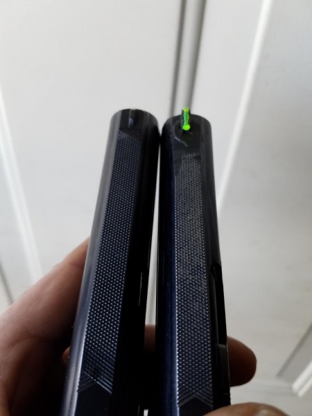

I removed the factory front sight and installed a Hi Viz Spark III fiber optic sight. The colors of the sight can be easily changed if so desired.
side by side
side by side

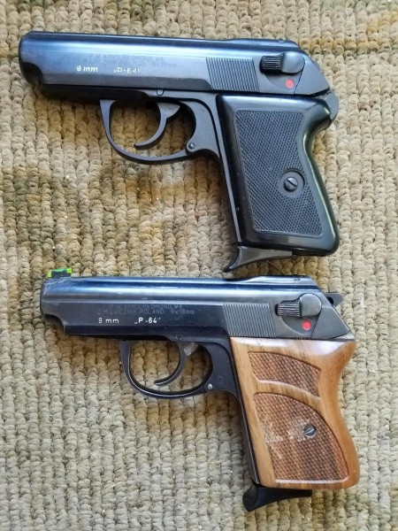

I changed the grips to wooden ones, I also lightened the trigger spring and I have an extended magazine release I will put in later.

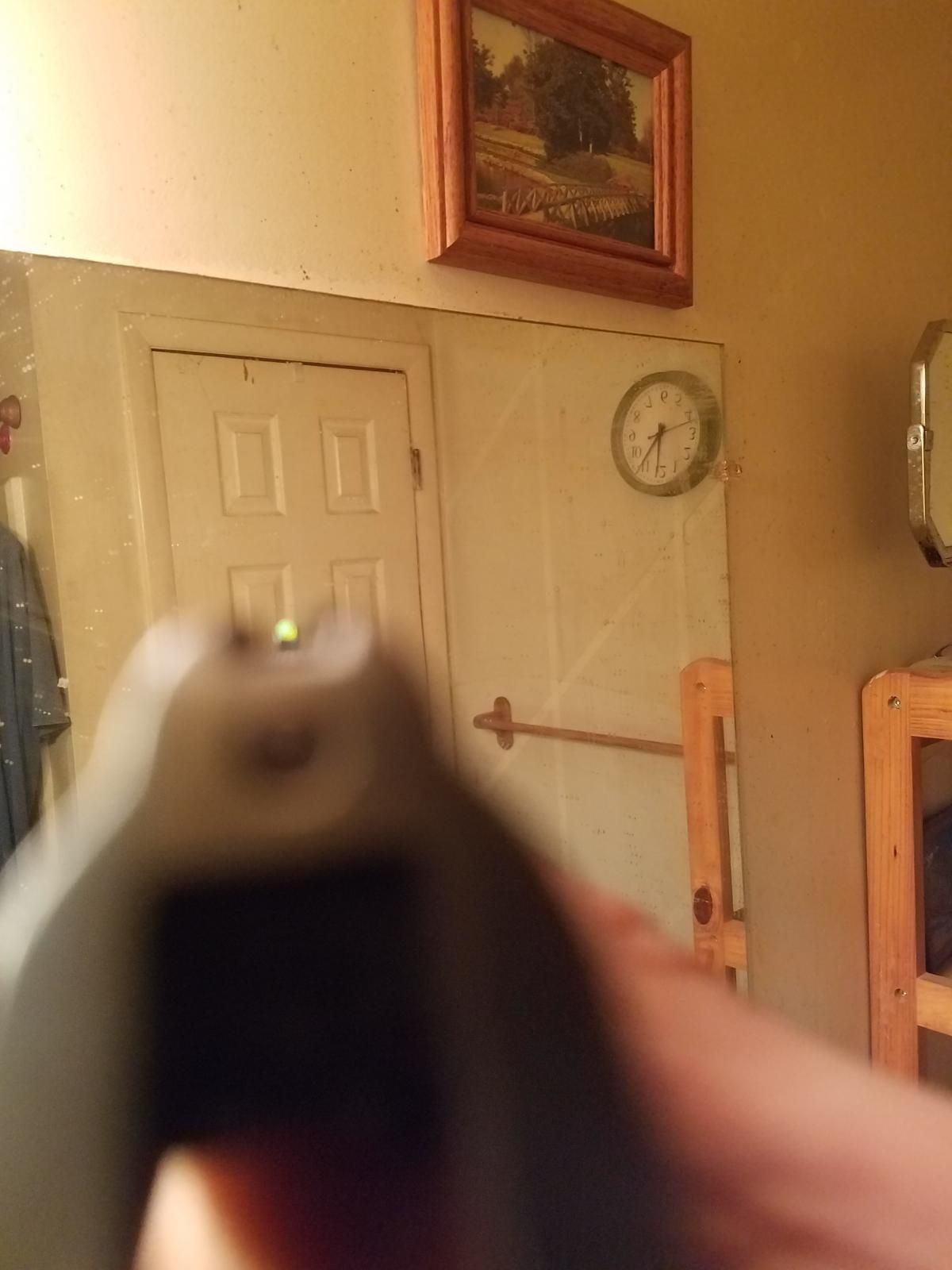

New sight picture
New sight picture

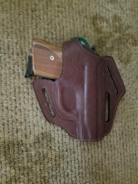

ready for travel
ready for travel
original configuration and as modified.

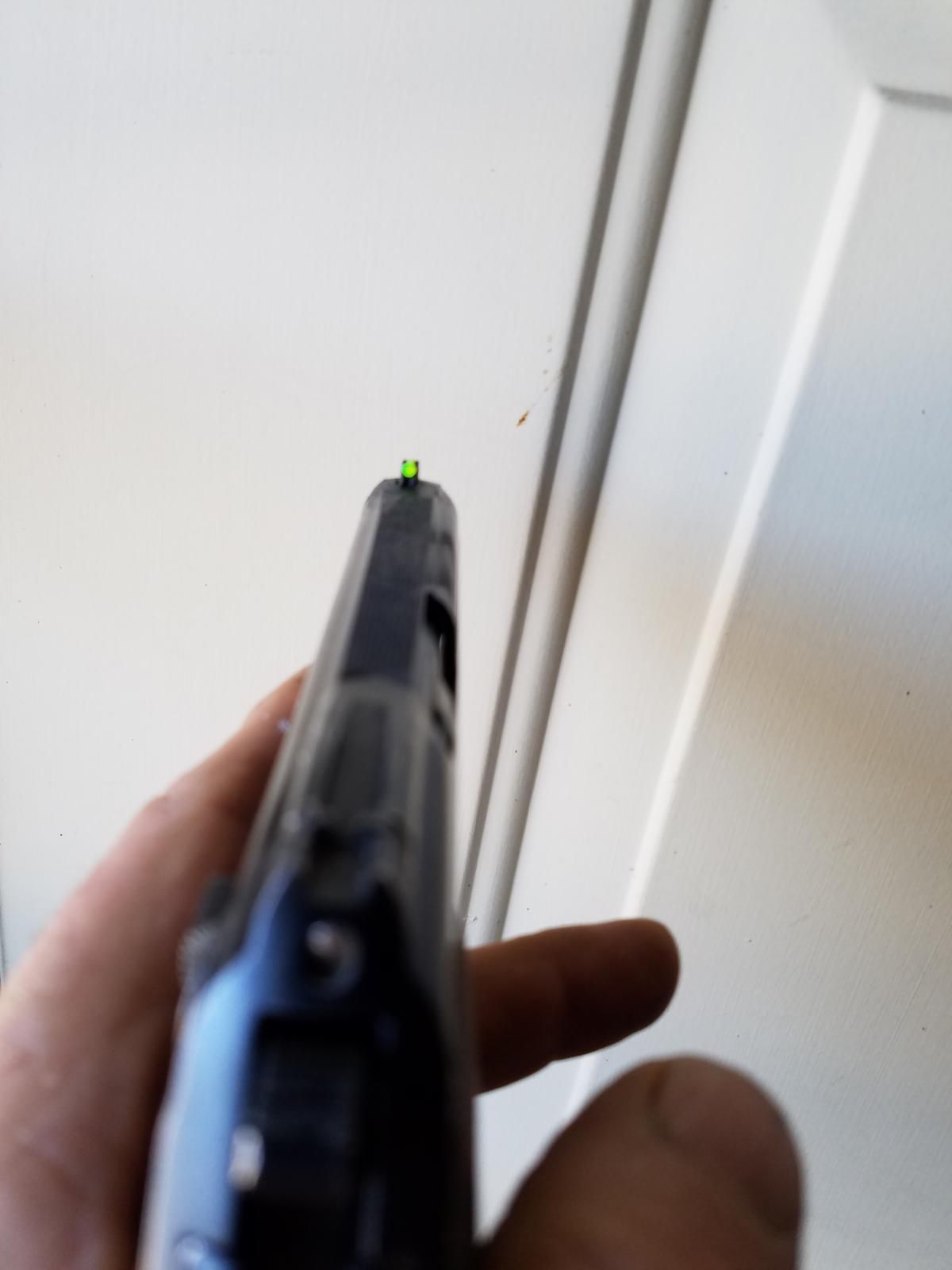

top of slide showing area with touch up blue after the grinding off of the original front sight.

Perhaps it is the camera angles, but is it slightly left of center?
superc
Posts: 49
Re: Front sight replacement
Post by superc »
It is camera angle.

I like your sight mod. I think the front sight on the P64 is it's only negative feature, they need to be a little more visible. Have you been to the range yet, I am curious about POI, and how well it points? I have a spare slide that might make a good candidate for a new front sight.

Where I live, I just go in my back or front yard and shoot as I wish. Neighbors are far enough away and I have hills and in most directions I own the land on the flight path. So no, this gun hasn't been to a formal range. HOWEVER, I have fired about 2 boxes of ammo through it since the mods were done and can not report any front sight related problems.
Regarding a change of the rear sight, I had initially considered altering or replacing the rear sight. I had an expectation the greater width of the front sight vs the original notch of the rear sight would cause an issue. I was thinking in terms of running a needle file through the rear sight notch to widen it, or simply replace the rear sight, however, at practical combat range, 5 - 15 yards that Hi Viz sight is really noticeable (see sight picture photo above) and I see no point to doing anything to the rear sight. For whatever reason on my pistol, with the new sight, at the ranges mentioned the bullet impacts close enough to what the front sight is covering that I see no issues.
