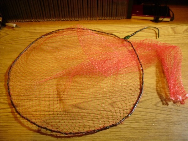

Re: 9x18 case length limits
Well that gave me a good idea for a afternoon of invention. I used the netting from a bag of oranges and a old bent coat hanger with a bit of floral wire and hey presto, a brass catcher. I bet this can pass as a pantyhose substitute. I also assume you can solder a small nut to the hanger to easily attach a tripod.
$20 something for a catcher seems like a total ripoff. It's cloth or some form of knitted fabric around a clothes hanger. JB7748 had a free solution that looks pretty good. I made one from a $4 mesh laundry bag several months ago.... using a clothes hanger. To each their own... Some folks are thieves and others are just too lazy and dumb and would gladly spend the $20.
