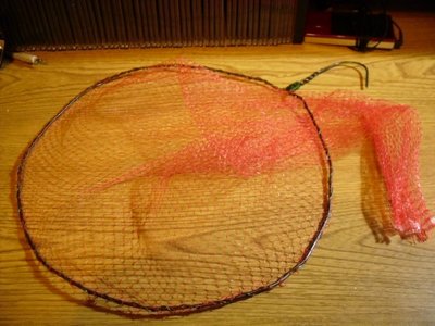

Well that gave me a good idea for a afternoon of invention. I used the netting from a bag of oranges and a old bent coat hanger with a bit of floral wire and hey presto, a brass catcher. I bet this can pass as a pantyhose substitute. I also assume you can solder a small nut to the hanger to easily attach a tripod.
