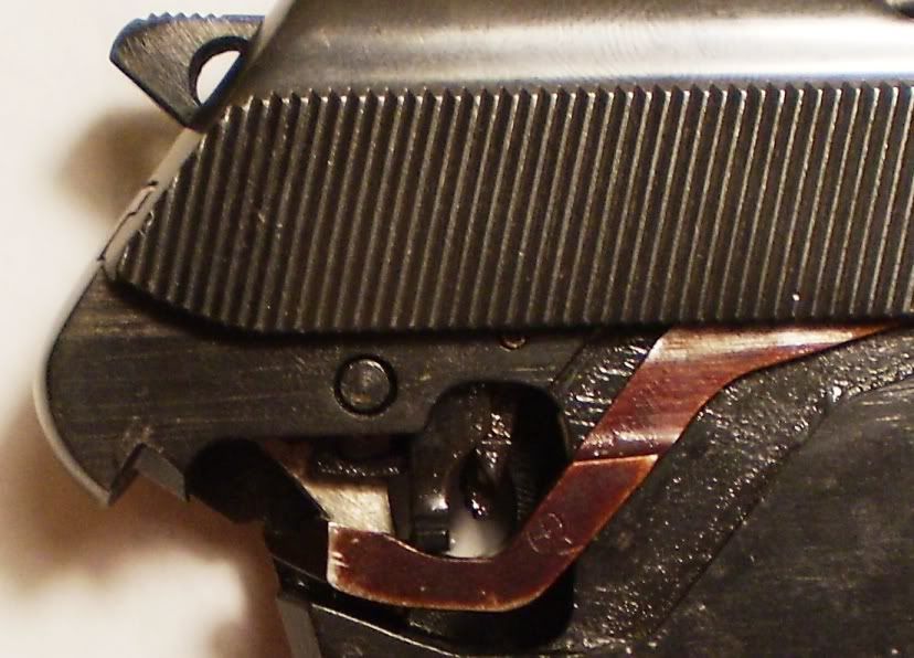

Pistol on SAFE. The disconnector is pushing the trigger bar down and allows the trigger to be pressed/depressed with no resistance. The disconnector is also pushing the sear forward so it cannot engage the hammer.

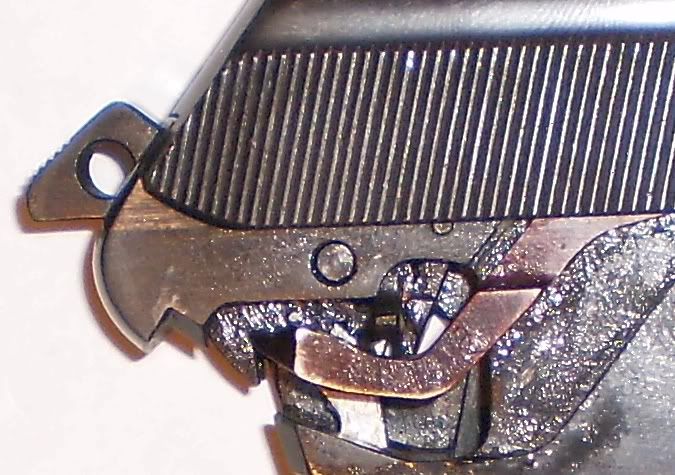

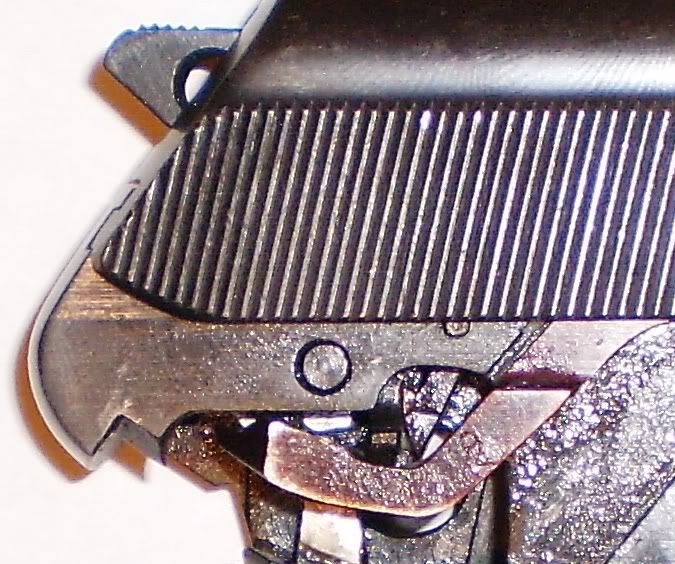

Pistol on FIRE w/ hammer not cocked. The measurement at the closest point between the trigger bar and the disconnector is 1mm.
Pistol on FIRE w/ hammer cocked. The measurement at the closest point between the trigger bar and the disconnector is ~2.5mm.

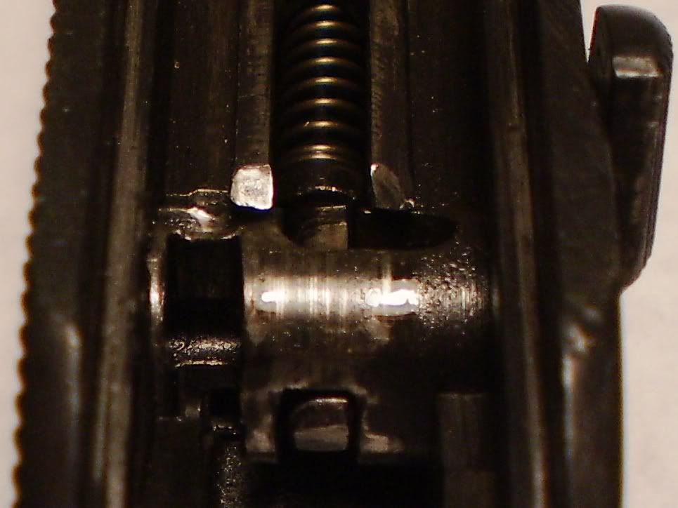

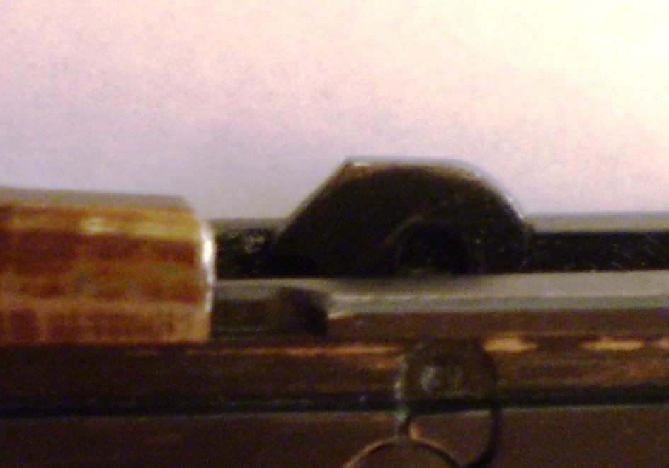

Here is my disconnector. The part contacted is the side on the left (pistol forward). It should be taller than the right (pistol aft). The roundedness on the aft side of the disconnector doesn't affect anything.
Here's my safety cam. Mine is slightly worn, but it doesn't look too bad.
