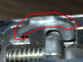

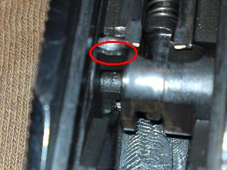

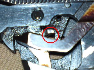

Here are some from my P-64. It has substantial holster wear on the finish so I suspect the culprit of the internal wear is years of the previous owner/user loading rounds while on safe. Thus causing the safety cam to violently slam forward into the disconnector.
Here is the wear on the safety cam, just behind the detent notch.
Here is the wear on the disconnector.
Lastly here is the spacing (with the slide on, fire selected) between the disconnector and the trigger bar.
It seems to me that there is just over 1mm of distance the disconnector has to travel before engaging the trigger bar. With this travel plus the amount of wear sustained during the service life of this pistol, these two parts will now fail if not lined up just right. Below are some solutions that I think will solve this or prevent it from getting worse.
1) Use as is with steps to prevent further wear ie: make sure these parts are always lubed, and only load rounds on fire, only using safety/decocker while slide will be stationary.
2) Modify the disconnector to close up the distance of travel, plus step one. This could be risky, if not done right it could worsen the action/function.
3) Replace one or both of the worn parts. This ideally would be the best solution however as there is a shortage of parts is less feasible.
For now I'll stick with step one as the pistol functions correctly as long as the recoil spring fits correctly.
