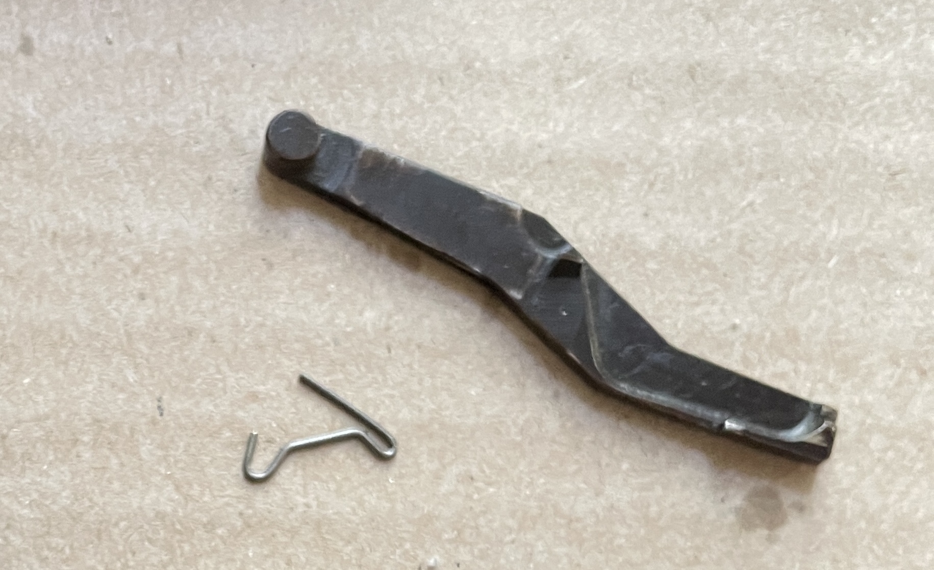

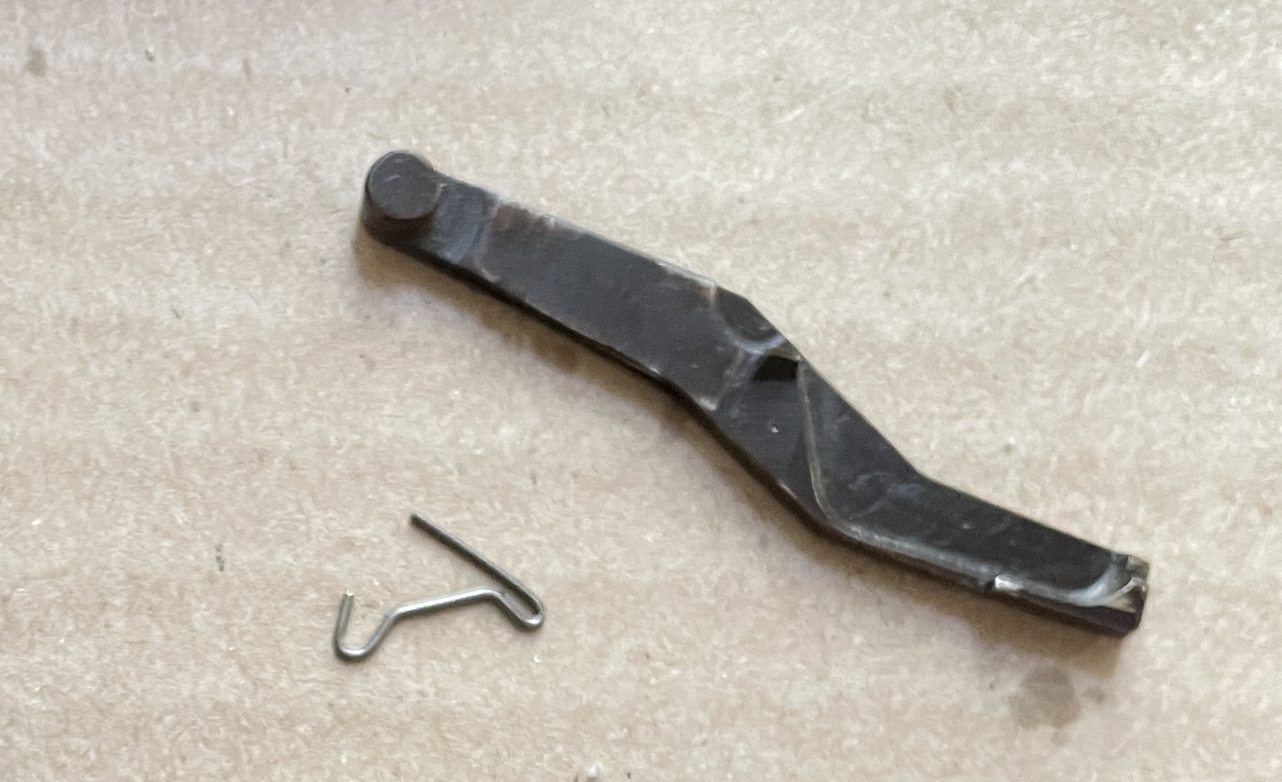

Hello. New member here. Hope to receive info on reassembly of P64. I removed the slide to clean. No further disassembly done. But did notice the side piece and small clip came off as I was attempting to re install slide. Any info on where clip re attaches would be appreciated. Sorry I couldn't upload larger pic, but full size pic was too big to upload here.

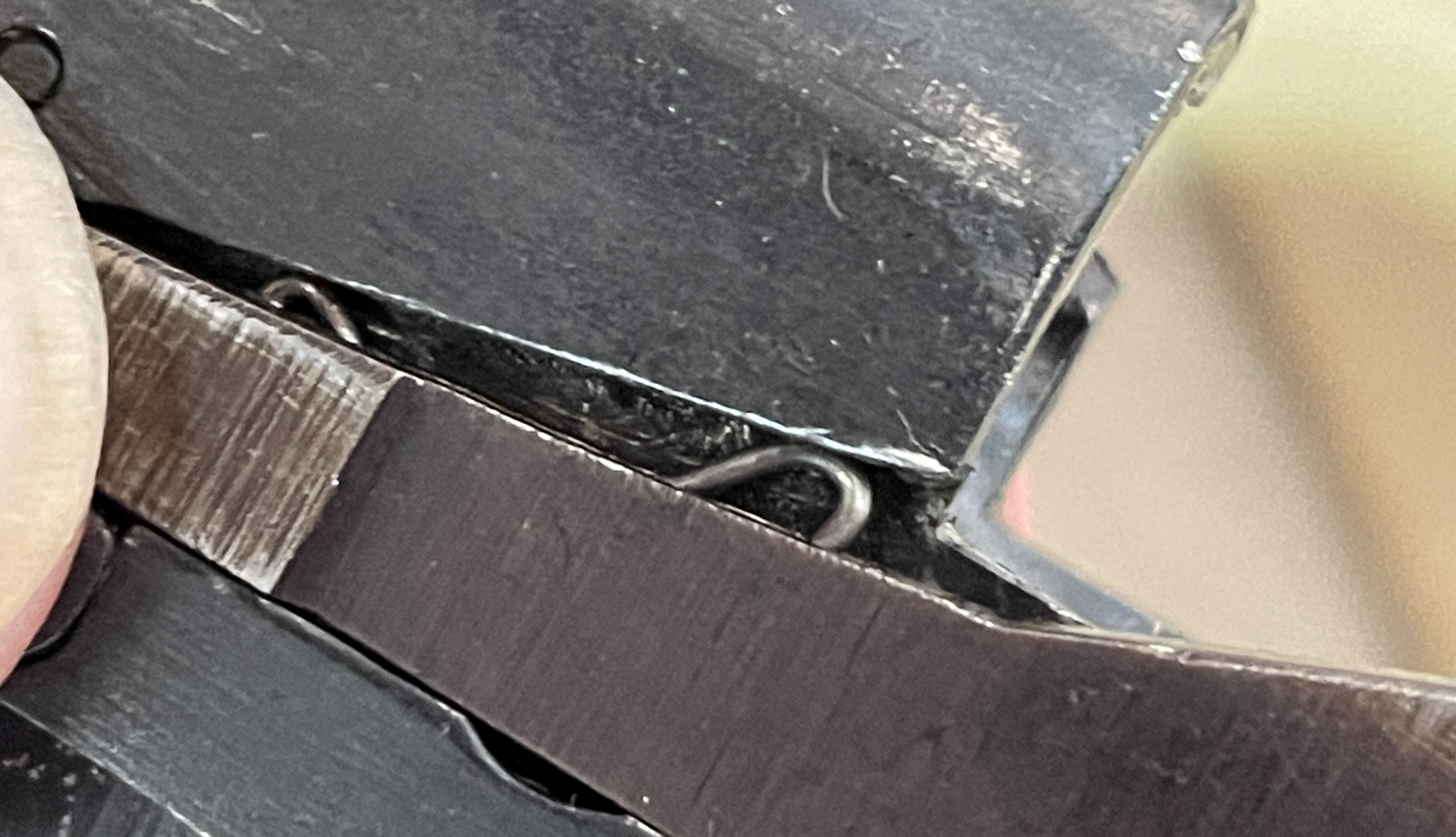

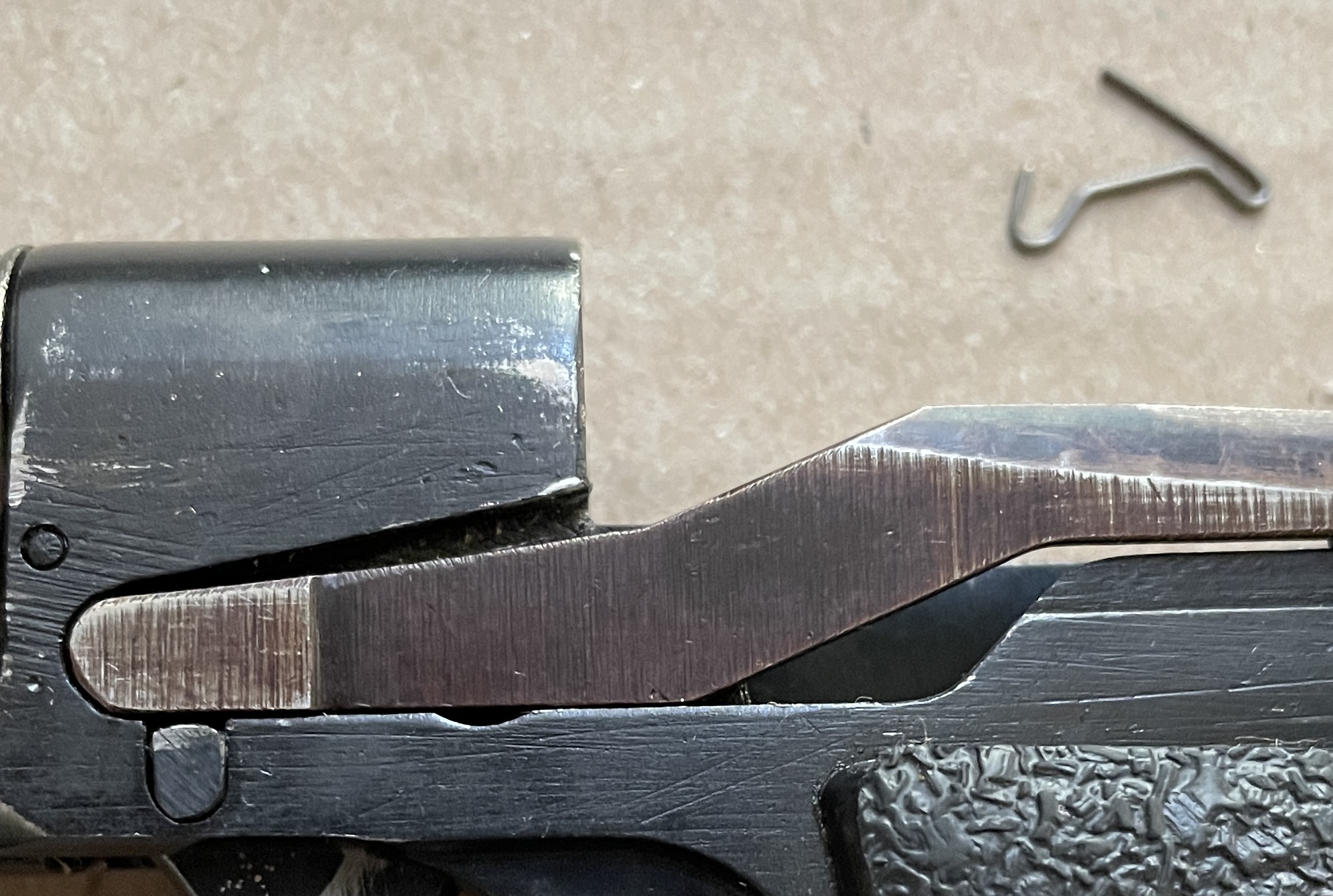

Another pic

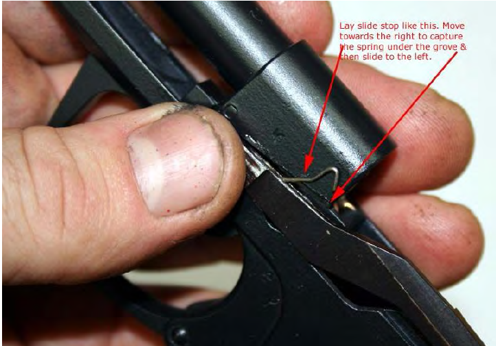

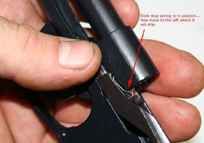

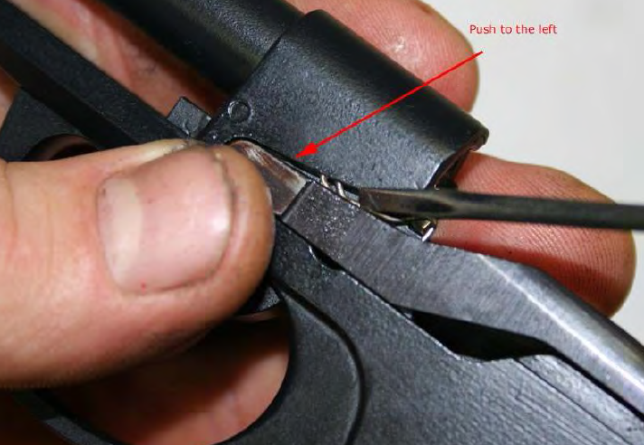

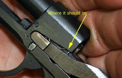

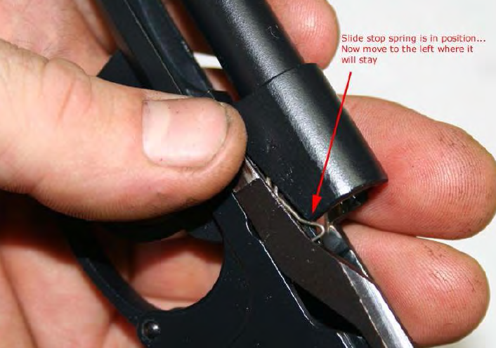

Here ya go:
Ross

Thank you. Very helpful

Glad I could help. The pics are from the Assembly Manual
