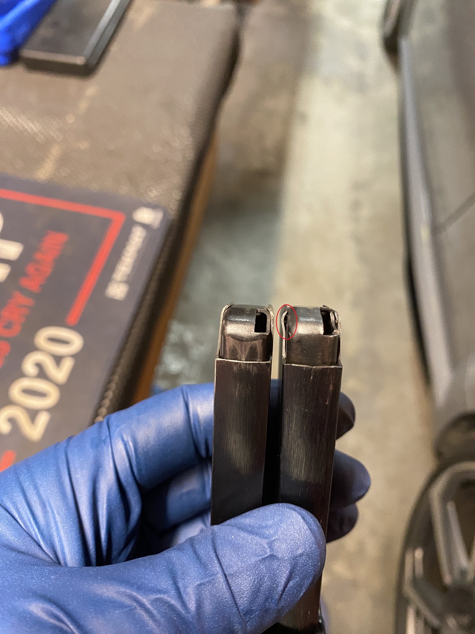

An update.
While shooting my P64 a few days ago, using a Numrich magazine, I experienced a failure to feed. Ten rounds later, the same type of failure to feed. Put the Numrich magazine aside, and continued shooting with an OEM magazine (no malfunctions).
The failure to feed occurred after 76 SAT rounds fired through the Numrich magazine.
Inspected the magazine when I got home: one feed lip is noticeably bent. And there are dents on the front and back side of the tube near the top. The dents on the back side are similar to those noted in this thread:
viewtopic.php?t=7475
The OP said the dents are occurring after about 100 rounds. Like the OP, my Numrich magazine is also becoming difficult to insert and remove.
None of my OEM magazines exhibit bent feed lips or dents in the tube, and all slide in and out easily.
Seems these aftermarket magazines (I'm assuming the magazine discussed in the thread above is also aftermarket) are only good for about 75-100 rounds. Perhaps a case of inadequate hardening?
