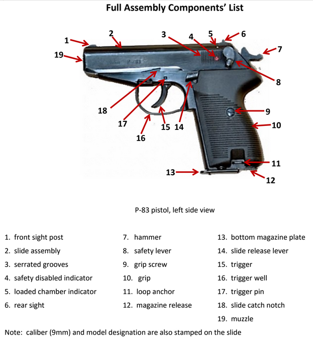

This has been discussed to death on this forum but I just want to know the exact part/s I need to changed in order to get it work properly. In case you are wondering I have the issue with the decoker not being able to move the safety when the gun is cocked.
Re: P83 decocker issue
The P-83 does not have a Decocker. So I don't think anyone is going to understand your problem: "the decoker not being able to move the safety". The Safety blocks the Firing Pin, as it engages the Disconnector, that disengages the Sear, allowing the Hammer to fall safely. There is NO separate Decocker. No one is going to be able to help you, unless you post detailed pictures with an explanation of what you are trying to do, and what is happening, or post a detailed video.
Now just to clarify; There are only three manual controls on the P-83: 1] Safety (on slide), 2] Trigger (on frame), 3] Slide Lock/Release (on frame). So what components exactly are you having an issue with and how are you trying to use them?

When the hammer is cocked I should be able to flick the safety and the hammer will go down and not fire which is why everyone calls it a decoker when I have my hammer down I am nit able to move the safety at all so I have to pull the hammer down a little bit to be able to safely drop the hammer.
