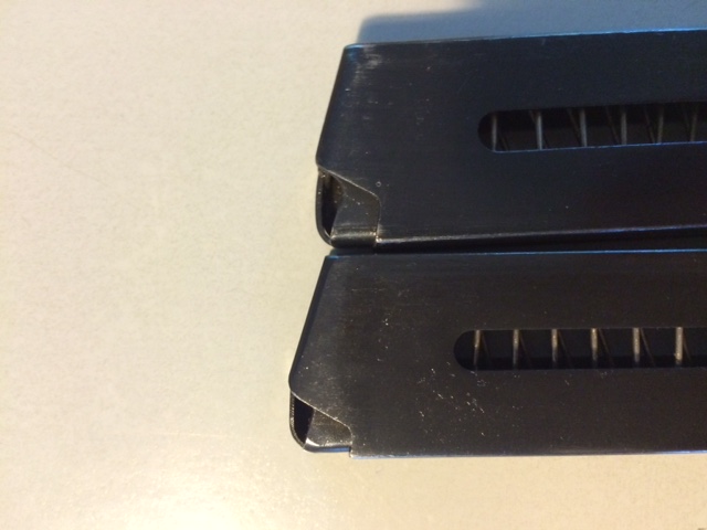

I thought I might have had the magazines swapped on my 2 P-64s, but after switching them out and test firing both guns that wasn't the problem. I took the magazines apart for both guns and cleaned them, although they were already pretty clean. The 1969 mag is on the left and the 1970 magazine is on the right. The feedlips look shorter on the 1970 magazine.

jed wrote:I thought I might have had the magazines swapped on my 2 P-64s, but after switching them out and test firing both guns that wasn't the problem ... The 1969 mag is on the left and the 1970 magazine is on the right. The feedlips look shorter on the 1970 magazine.
It has been said it makes a difference. It could but you couldn't prove it by me. I have 3 - a 1977, 1975 and 1968. My 2 grandsons and I go together and in the chaos that results during "P64 day" the 6 mags get mixed (obviously!). We've never noticed mag-related problems. I marked the mags to each gun (for what that was worth...) and I pair the mags up after "P64 Day" is over. Next time out, same thing, so I'd not worry too much about that and put it last on the list below spring weights, cleaning and ammo brand.

I would agree. There is a difference in the magazines for some reason, but it doesn't seem to make a difference in the function of either of the 2 P-64s. Boths guns are really clean. I have not polished the feed ramp of either of the 2. It could be the ammo since I have tried only one brand that seems to work reliably. I guess I can try different spring combinations until I figure it out. I really like the P-64, but reliabilty seems to be one area where it's hard to beat a Makarov.
