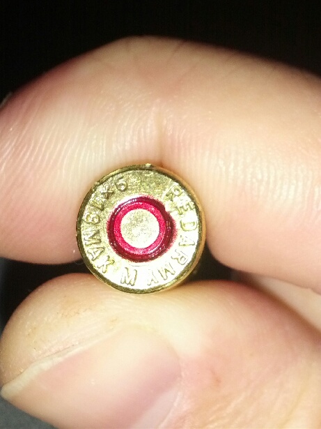

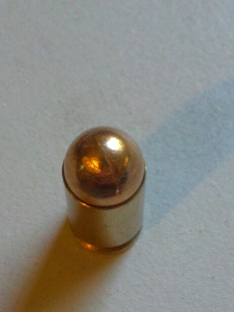

Started loading the magazines with five rounds each, and the issue persists. After the first shot, the second fails to feed. I've got a couple photos here of one of these FTFs. You can see the bullet has a gouge along the center of the nose, makes it look like it was pressed together from two halves, and a dent just to the side of it. There's also a ding on the headstamp (right between the R and E, purty close to the primer, -that- was close!).

Back again. Tried shooting a couple of mags of WPA and Brown Bear, and the same issue occurs. So it's not an ammo problem. Scrubbed and oiled the whole thing down again, and the very next mag didn't FTF on the first shot, but it happened again on the second. It occurred to me after looking at the photo of the bullet above, there might be a burr or something on the feed ramp. I'll have to borrow a dremel or something from someone and polish it down, see if that doesn't fix it.
