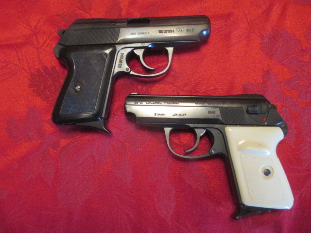

Finally figured out how to get a down-sized photo of the new and old P64. A new laptop complicated things for me as well. I try to keep up with computer stuff, but at 65 it's challenging. I'll take a screwdriver over a keyboard any day.
The black gripped one is the newly repaired de-cocker $119 special. I love the tiny import mark. The white grips with thumb rest (from Zee) are on my first pistol. You DO need more than one P64!
Mike
