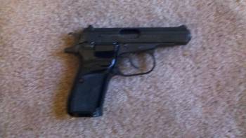

This is the G96 on my CZ 82...I stripped the paint and blued the whole pistol...I just did where the holster wear was on the P64 and it blended perfectly!

the G96 looks very nice on the CZ82. have you had any problems with wear? the P64 is my primary concealled carry gun right now. i just bought a Kahr pm9 but havent shot it enough to feel safe.

No problems with wear, yet. I've used it many times since the bluing was applied...
