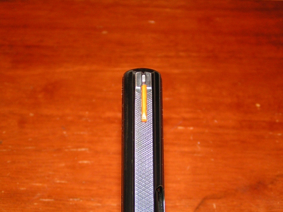

hey guys, well I have finished my sight mods. I bought a browning Buckmark Hi-Viz shotgun bead front sight, cut it off right behind the magnification tube and mounted it backward replacing the front sight after milling a .20 deep slot in the front of the slide which removed the front sight, then drilled and tapped the slide for the sight mounting screw of which 5 different sizes come with the sight, and secured the sight using locktight. The bead sight comes with red and green fiber optic tubes. I then opened up the rear sight blade a bit (SLOW careful filing). Then touched up the affected areas with cold blue and viola! Shoots to point of aim like before the changes and boy does that front sight show up in any kind of light. It does not snag on my Uncle Mikes IWB holster and I like it alot. Total cost including sight is $75.00 which I am more than happy with. What do you guys think?

Thanks guys. buy the way, the $75.00 includes what I paid to have the slot milled in the slide. Dennis, I gotta say for pure creativity with few materials used, yours is genius! And Billhac, yours is awesome, but I have learned the hard way from previous experience that switches and batteries fail at the worst f$%*&^% times! And with my luck it would be at the time I need this the very worst so laser sights are a no go for me. But don't think that I am not in admiration of your setup, cause I am. Anyway, next up is refinishing.
