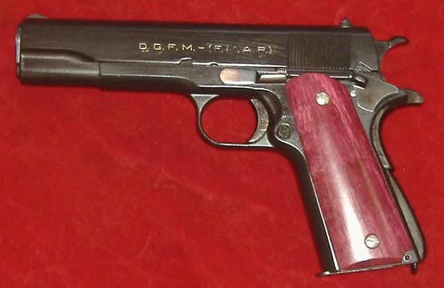

just get some $8.00 ceramic header paint , not barbeque paint ,
this a before pix
after
I did this on a friend's gun in one day, with ceramic header paint, I use the oven to bake ,
this is one of mine
baking in oven
finished

Hay NORM, what brand of ceramic header paint are you using, the one brand that I found today required that you bake the metal at 250, 400 and 600 degrees respectively with at least one hour or until cool between bakes. I checked my oven and the best I can do is 550 degrees. I would like to pick up the product before the pistol arrives and may need to order from the manufacturer. I'm really excited about this project and am waiting to hear from you.
By the way, is the picture of the pistol hanging in the oven raw sand blasted metal or a finish that you used? Either way I really like it and may try to duplicate it if I can find the correct color. Thanks again for the information, can't wait to see how things turn out.
G.R.
Re: Cerama- Coat for Aluminum?
GR
the one hanging up was sand blasted , whip down with alcohol you can change the bake time and temp. start low and work to highest tem at the highest tem and more time like 60 min at 500 it takes about 4 to 6 hour's to bake it on ,a alloy frame 500 degrees is high enough I think the only brand that's being made right now is VHT there used to another brand out there but VHT bought them out , you can bake the paint on 200 degrees at at something like 7 hours , or you can run it up in different stages
I like running up in different stages its a lot faster way to do it on the last stage let cool in oven all the way down
GR
