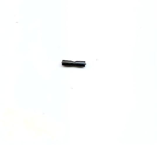

Walther PPK Trigger Guard Hinge pin
Post by zoobie »
I see from previous posts that people have tried Walther PPK trigger guard hinge pins, but have not read if they work. Can anyone tell me if they work ?
Thanks Zoobie

Re: Walther PPK Trigger Guard Hinge pin
Post by zoobie »
I have tried 3/32 roll pins and they work out after ten rounds , a 1/8 pin guage fits , but I can't get a 1/8 roll pin in. That is why I was wondering if a PPK hinge pin would work . My original pin was broken when I bought the gun.

try a metric roll pin
It's probably metric.
3/32 = 2.38mm
1/8 = 3.17mm
Try finding a 3mm rollpin. If they make half sizes, try to find a 2.5mm. I am positive they make them, Google searched showed some results.
I just see Norm beat me to it. Oh well, FWIW. I spent too much time converting the fraction to mm's.

zoobie
or you can get a nail almost the same dia. , chuck in a drill , turn a v notch in with a file cut it to length, heat up till cherry red drop in oil
