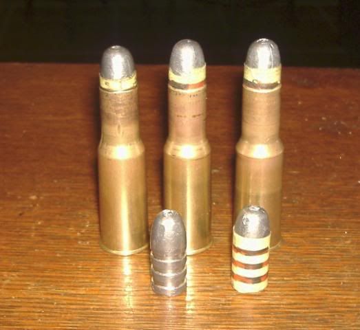

pix of 3 loaded
65 grns of triple 7 ( its a BP substitute ) 60 grns triple 7 for a 45/70
410 grn paper patch pure lead hollow base bullet size and lube to .457
one 9 mm CASE of with cream of wheat filler
a comparison left to right
577/450 , 303 Brit., 45 acp, 9 x 18
