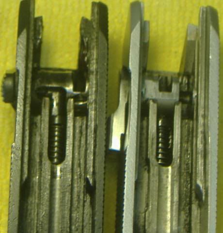

I thinks that's normal wear and the disconnector is suppose to wiggle some
the one on the left is 1976 on right hard chromed 1969

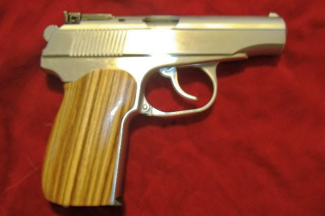

I had the whole gun hard chromed ,had it done by http://www.elitecustomguns.com/
some others I had done
Yet ANITHER safety issue/question
Wow, that is some nice work. I should have something like that done. I don't care for the shiny, tho. Have to go with the black chrome, like Ford's in Florida used to do. Just my personal preference.
Thanks for sharing, Mr Norm.
