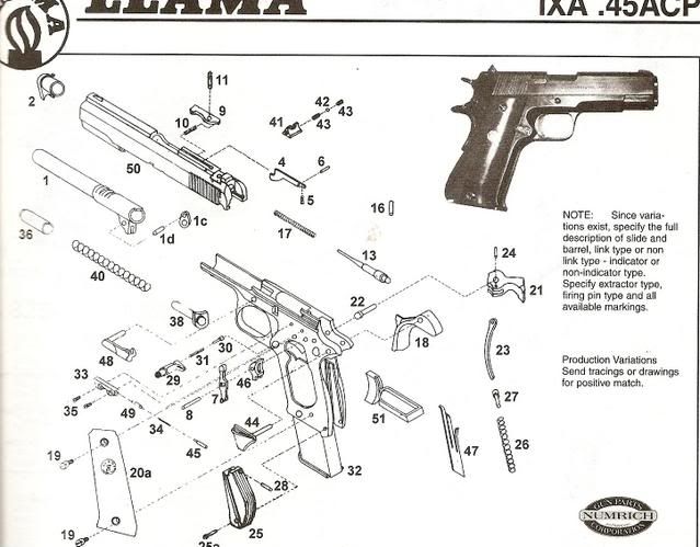

anj, so It is under the sight? Gunny, I may have to stop by the local book store and see if its there, and Norm, that graphic is very useful, I was thinking to my self "now how am I going to get this thing back together when I'm done, ???

Trent I believe so but never have taken one like yours down, but the star and a few others of simular designn are that way. if you look close on ther drawing Norm sent looks like a spot there. You might want to catch with some one more knowledgeable then I . What I have done in past I have called the suppliers and asked for help .. most are pretty cool ,but it is the luck of the drawer

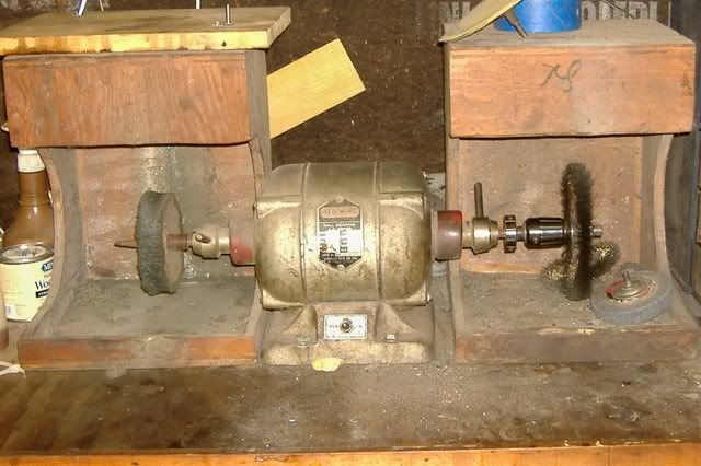

THIS IS WHAT I USE
I think I would recommend this one
