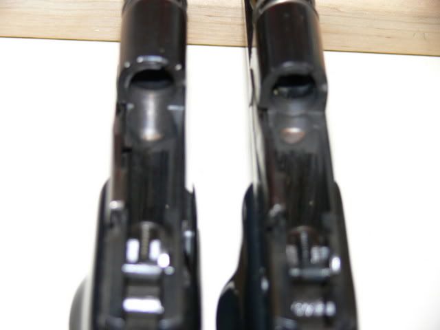

Here is a pic. On the left is 1976. On the right is 1968. A little fuzzy, but you can see the ramp, the feed difference.
hollow point feed
blinddog
there is a big difference
at the beginning of the chamber I think I grid off that ledge not going into the chamber if at all possible

hollow point feed
Post by blinddog »
OK Norm, I just wanted you to see it. I think if I take care and time I can do it. Once again, thanks a bunch.

Post by saands »
Yep ... that is what mine looked like ... I'm a little surprised that it feeds JHP's at all! I think that this is the best reason to have two of these fine little gems!
Good luck and go slow ... remember you can always go back and take more metal off, but it is really difficult to add metal back!!!!
