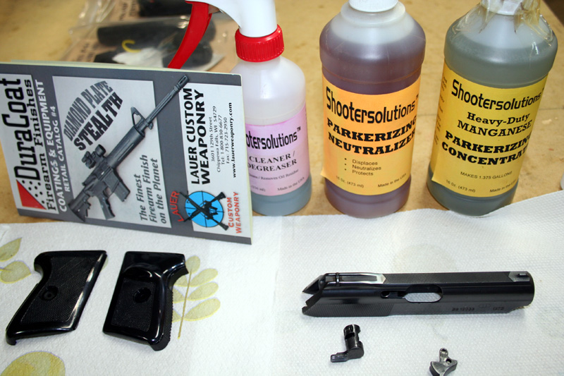

Got that trigger guard off...

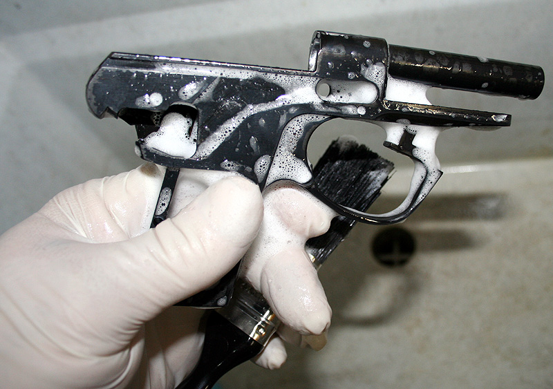

Degreasing before parkerizing.

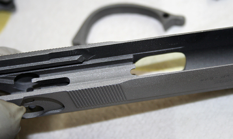

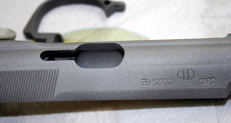

After blasting...

Blasted the grips which left them flat and gritty wait till you see them after duracoat...

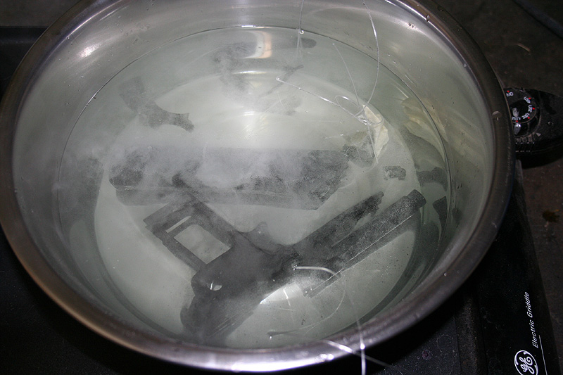

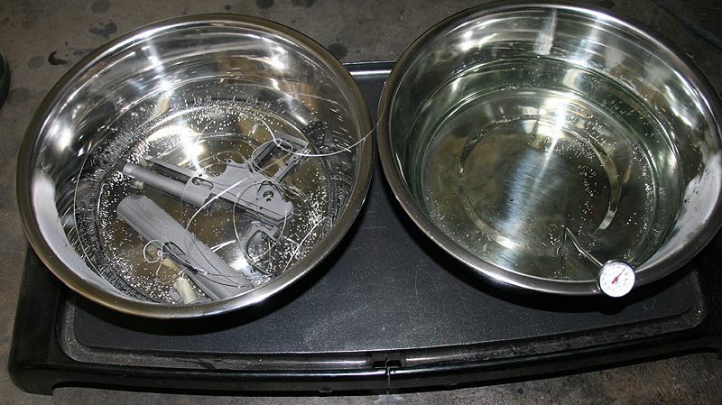

Heating the parts in distilled water up to 170 degrees before transfering to the manganese parkerizing solution.

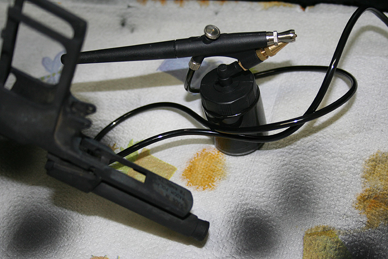

Spraying with Duracoat matte black
