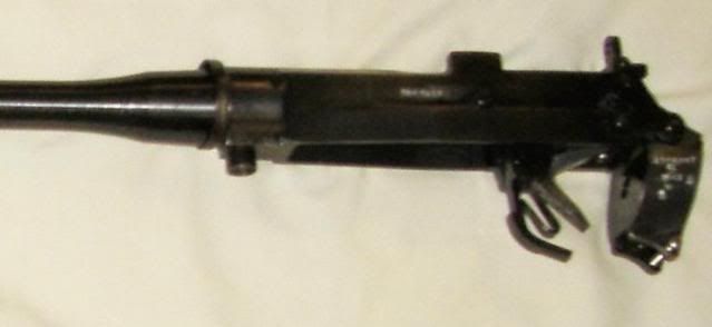

There are a lot of good cold blues out there
here are some
http://www.brownells.com/aspx/NS/store/ ... 10&si=True
my personal favorite is BROWNELLS OXPHO-BLUE LIQUID
This a barrled action i just did not to long ago
