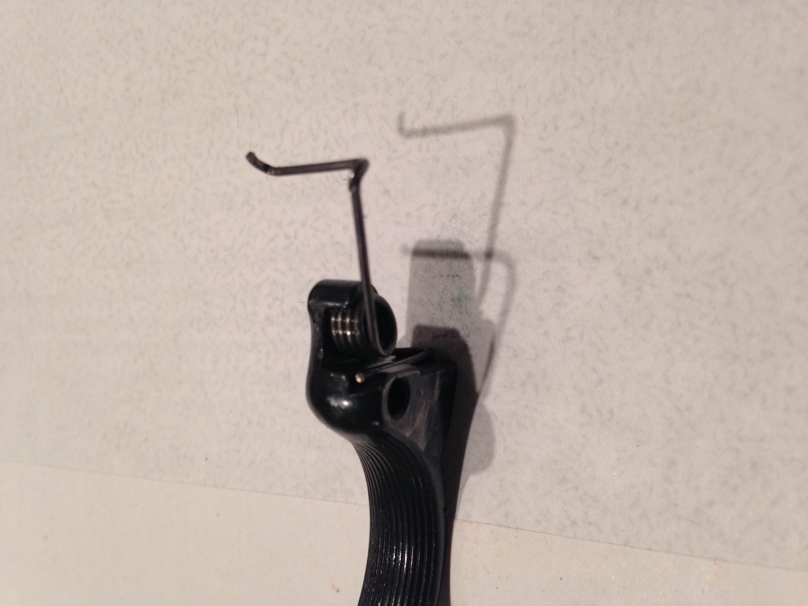

Post by GMAN31 »
Ok Gents, I'm back at it. Trigger and spring out and issue in hand. TS has fatigue crack at first 90 deg bend. Pic gives some idea with the discontinuity in the elbow. No strength left and will fall off if I just push on it a little.
Ok so off to find the replacement or two.
GMAN
Posts: 1147
Re: FEG SMC 380 JUST STOPPED FIRING!!
The spring for the PA63 is the same one amd you can find them at Numrich too.
