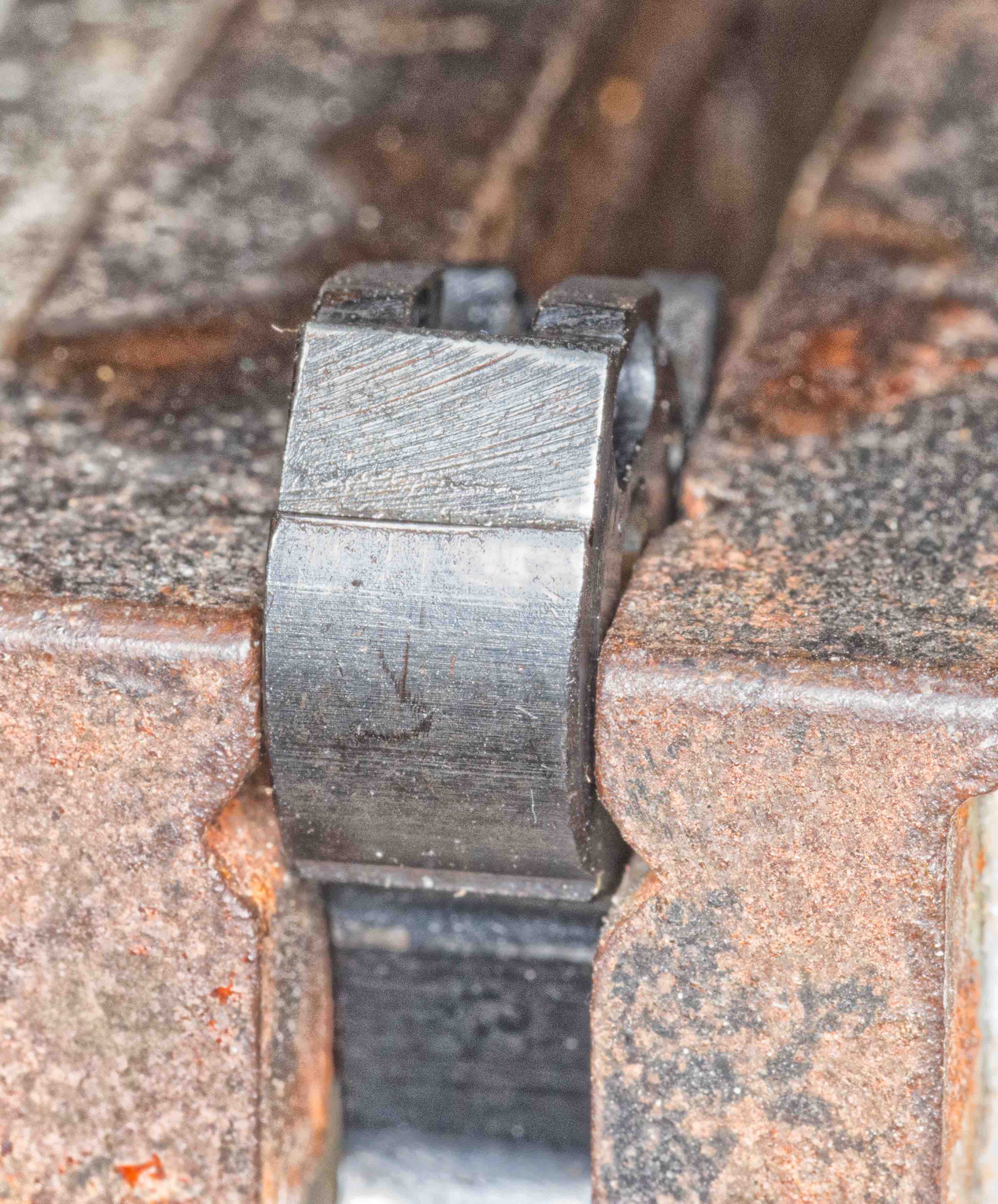

Thanks for the information. I do a lot of precision work and do have many sizes, shapes and grits of diamond files and other micro tools. After reading more about the various changes made to hammers over the years of manufacture i suspect that the sear does not have positive engagement with the hammer due to improper angles or to some persistent cosmoline or other contaminant partially filling the cut out. I also plan to check if a stiffer sear spring would help.
Worst case is that I will require a new hammer and sear which I am already trying to locate.
Re: Please Help -- 1 oz SA trigger pull

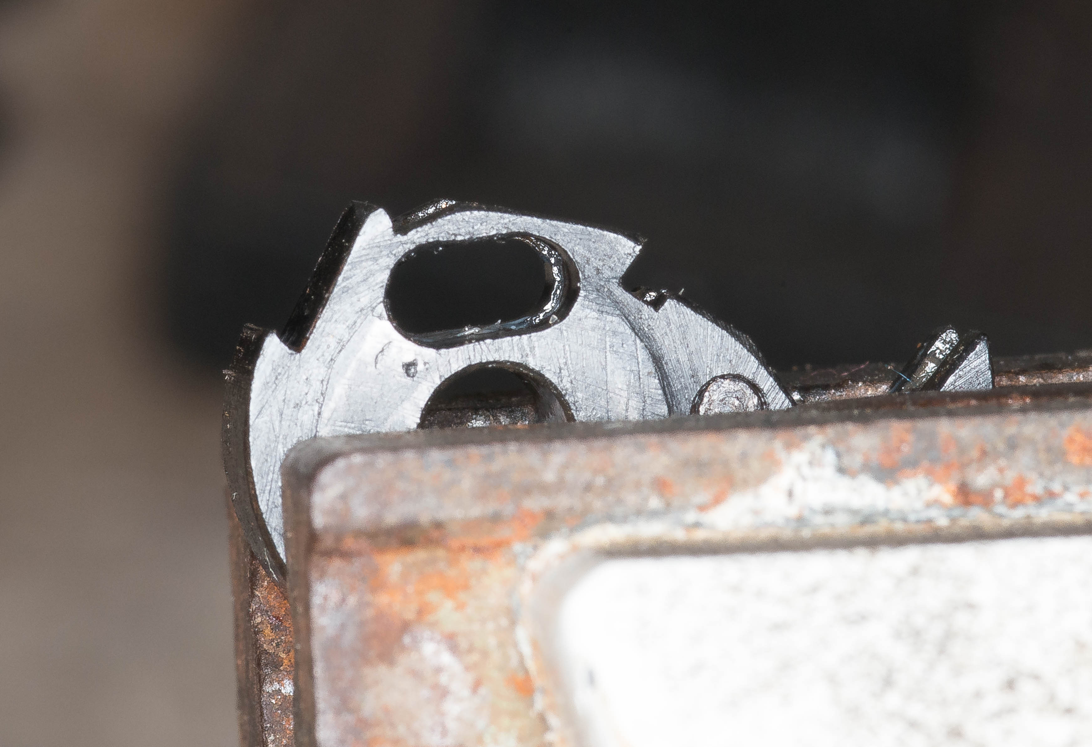

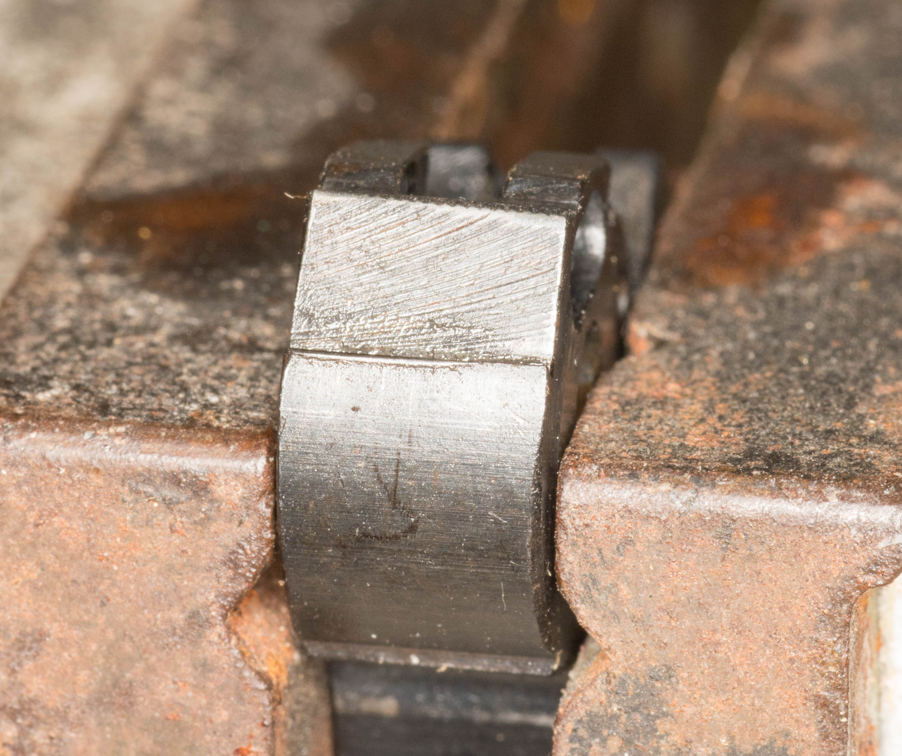

You are correct! The contact catches on the hammer where it engages the sear are way out of square and are not parallel to each other. If you look at the attached photos, you can see that the lower engagement point is uneven and the upper engagement slot is sloped down to the right.
The lower slot can be honed straight but the upper may be too far gone.

Are there any visible tool marks that would indicate a poorly attempted recut job?
I don't see any evidence of re-cutting. It almost seems as if the part was not properly hardened and has just been malformed from use.

The notch that matters the most is the bottom one. The top is the half-cocked position. I just noticed it looks a little like that slot was not cut completely to the end. I think it would be okay to square that one up since the half-cocked position is not critical to the firing of the gun. The bottom slot looks like an easy fix.

Since the half-cock is so deformed I am wondering if hammers were occasionally made with soft metal? Since I already have photos of the worn hammer and have my macro lens and strobe set up I will document honing the hammer and could post it if this works.

Honed the edge of the full cock notch and cleaned the edge of the sear. Reassembled the gun and took it outside to put 6 rounds through. Even though I barely removed any metal, the hammer would fall when the slide functioned after firing the first round but there was no detonation. The gun required a DA pull to set off the next round. Of the 6 rounds 4 required a DA pull and 2 fired on a controlled SA pull.
