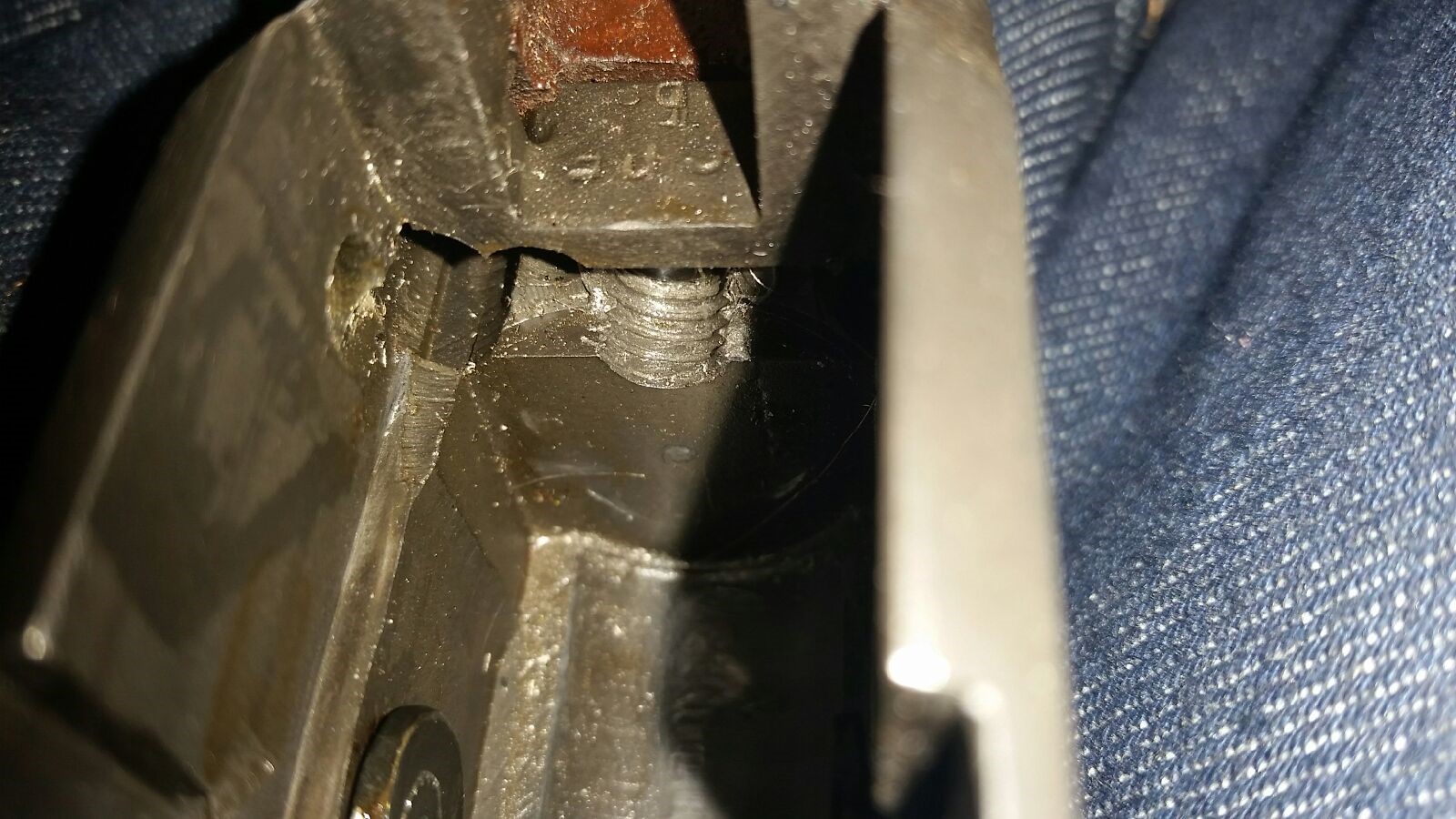

At least, unusual to me. Normally the face of these things are slotted, but this looks like a roundbolt with some kind of threaded plastic washer? I have no idea how to get this thing out without taking apart three other things on the gun.
https://imgur.com/zVM8zvB

It's the bolt fastening a stock to a shotgun. In an Armscor/RIA M5. The manual's exploded view shows it as a hexbolt, but it looks round. And the manual also provides no information as to what size socket I'll need to get it out. And I can't get any useful answers out of Armscor, other than "We don't recommend removing the stock". I didn't buy a Hi-point, I expect to be able to take my gun apart.
Re: How do I get this unusual stockbolt off?
Doesn't look rounded to me looks like a socket will fit it.
I would just try different sizes until you find joy.
Good luck.
gman68w
Posts: 184
Location: Myrtle Beach, SC
Post by gman68w »
It was hard to tell with that lighting, but yeah it's a socket. 13mm or 1/2 is what I'm told will work. Now all I need is someone to bum a socket set off of.

Yep, 12mm or 13mm iirc. I ended up using a 1/4" drive ratchet, a the socket walls on a 3/8" drive were too thick to get down into the pocket.
edit: The socket for removal shouldn't matter, the 3/8" drive was too thick for the wood stock. HOWEVER, I think the bolt was too long for my situation, and i ended up using the slot screw/washers that came with the wooden stock I fitted.

Looking at mine right now, and actually thinking back more clearly, it is likely a standard thread. There is very little chance that the old JC higgins my stock came from was metric. :oops:
My best guess would be a 1/2" bolt with 1/4"-20 threads ~6" long. Take the one that came off with you.
Also, get enough matching flat washers to make up a half inch or so. If the bolt is too long, it will stick past the rear of the receiver and the action will bottom out before the shell lifter actuates.
