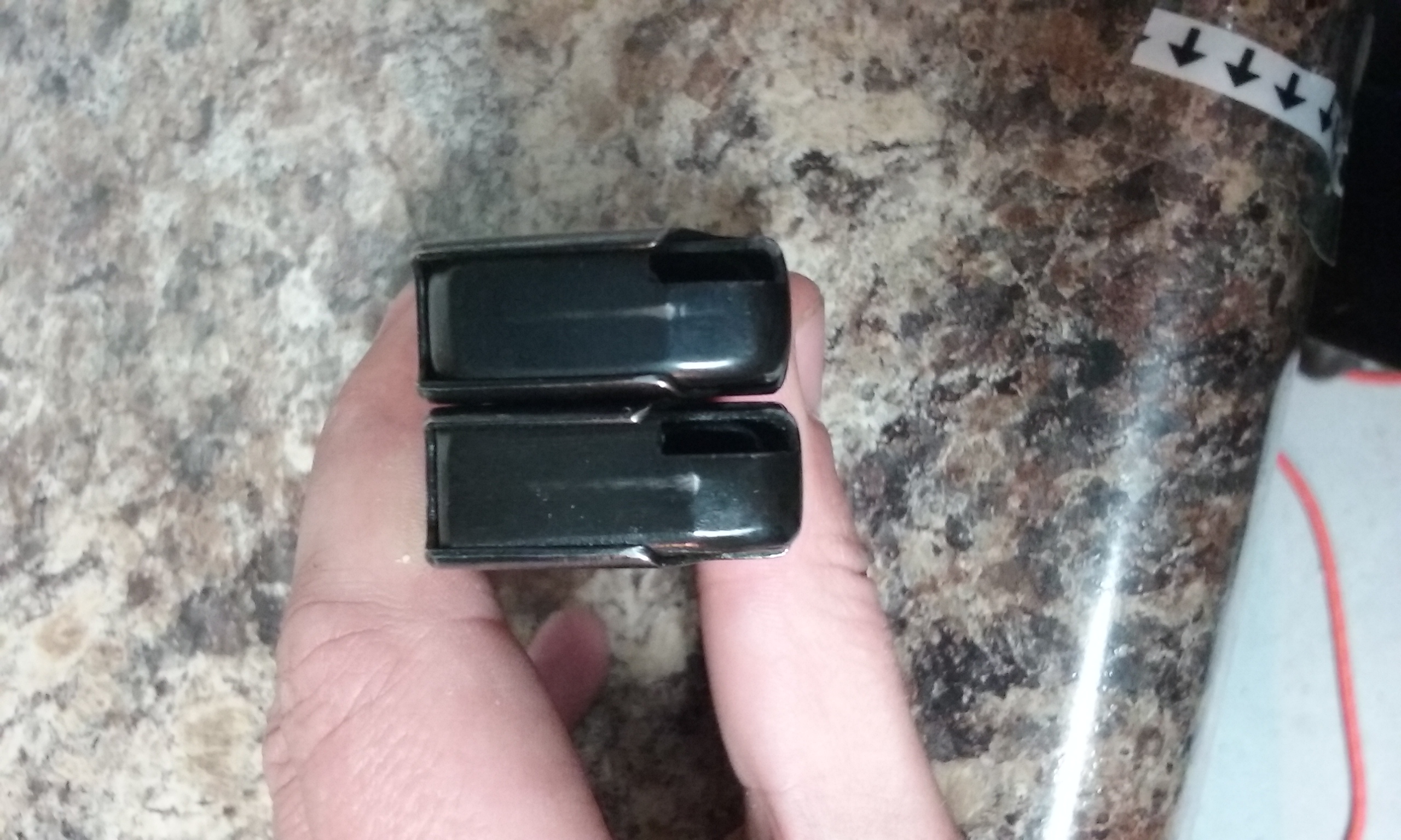

I just shot my P64 today after owning it for 3 or 4 months. It stove piped maybe 5 times out of about 85 rounds or so of Fiocchi 95gr FMJ. It has 2 magazines with it and I noticed that it was the same mag every time it stove piped. The mag that does it has shorter feed ears on it than the other. My P64 is a 1970 with the round hammer spur. It shoots pretty accurate, I have to say that the sights on there are really small and I'm more used to Glock type sights with the 3 dots. I really had a time getting those small sights in focus but if I was defending myself it would be more point and shoot, and it's plenty accurate enough for that.
There was one other failure to fire as it just didn't go off. I recocked the hammer and it fired on the second strike. I guess it was just a bad primer in the shell since the dents looked good in all of the spent brass.
apparently the magazines with the shorter ears aren't for the 1970 model and the longer feed eared ones are.
Does anyone know the magazine specs?
This picture is from a seller on ebay who has both kinds for sale, but you must tell him which one on the order.
