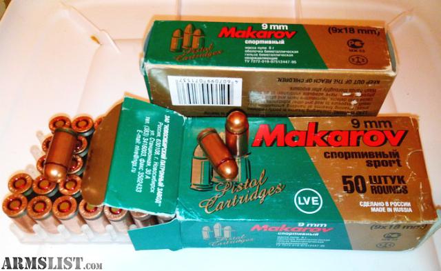

Try different ammo brand/type. When I installed a heavier main spring from Wolf GunSprings to reduce the recoil pounding on my hand, used original factory magazines (with serial number engravings) and used Red Army Standard ammo or LVE Sport ammo, the slide locks open after the last round and everything works fine (see attached photos) during every shooting session. Those ammo have a good kick! I really like ammo which has red color rings. but Silver/Brown Bear, TulAmmo and some others may be too 'weak'.
