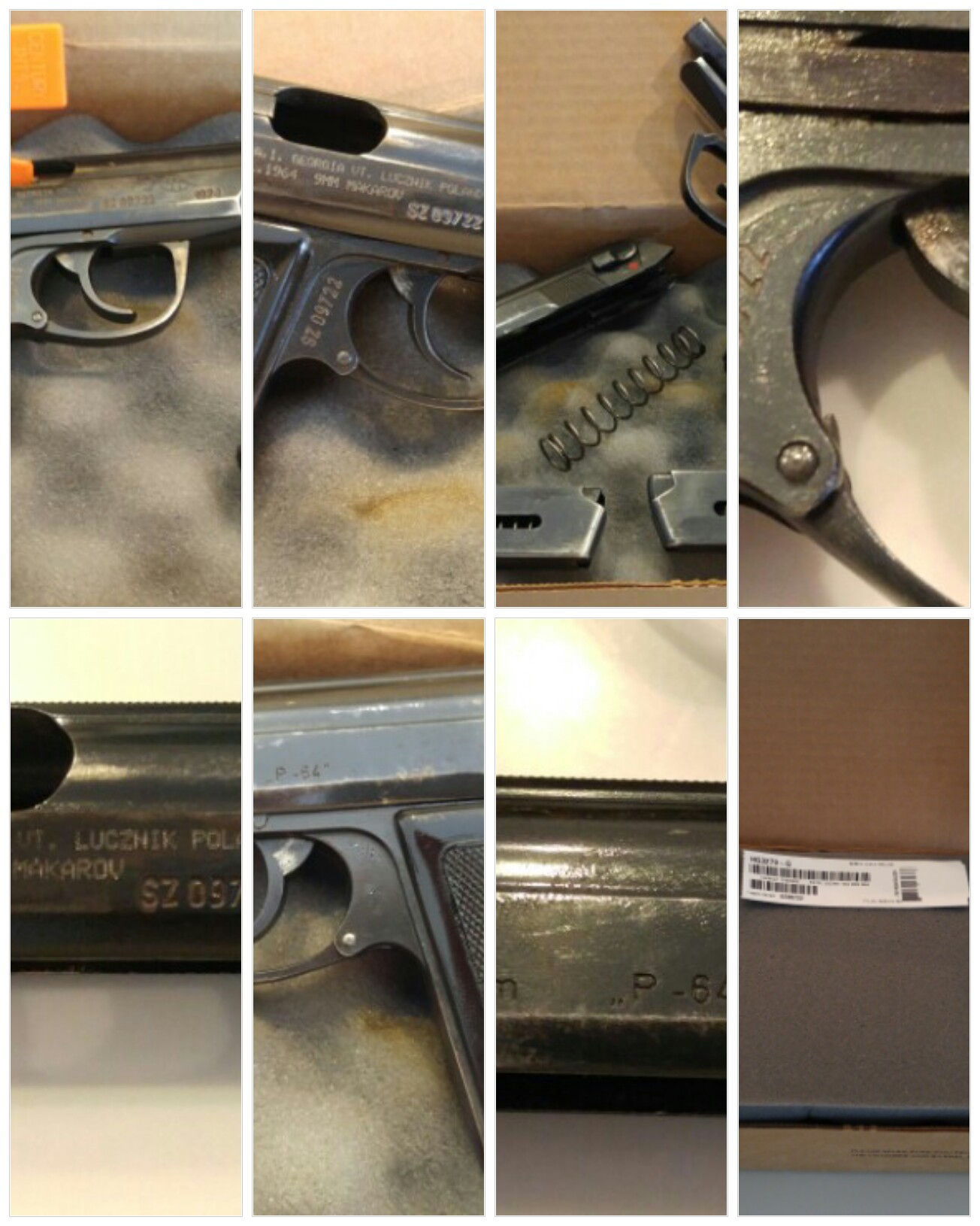

My lovely wife went and picked it up at the post office today. I'm extremely pleased. All seems to match. The "bidding" was minimal near the import markings...which also looks about normal.

That's not too bad. Great project gun.

It's much better than I was thinking...I think I'll keep it original. Maybe lighten the trigger pull, if anything. That first pull is a beast.
