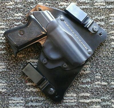

rumcrook
Posts: 7
Joined: September 20th, 2014, 1:31 am
Re: new to forum thinking of getting a p64 as carry weapon.
Post by rumcrook »
Went with aim, got a flawless example. Put in wolf spring and carry it with a shtf brand hybrid leather/kydex holster I found on amazon. And load it with Hornady Critical Defense hp it's been doing real well for me, flat and confortable
