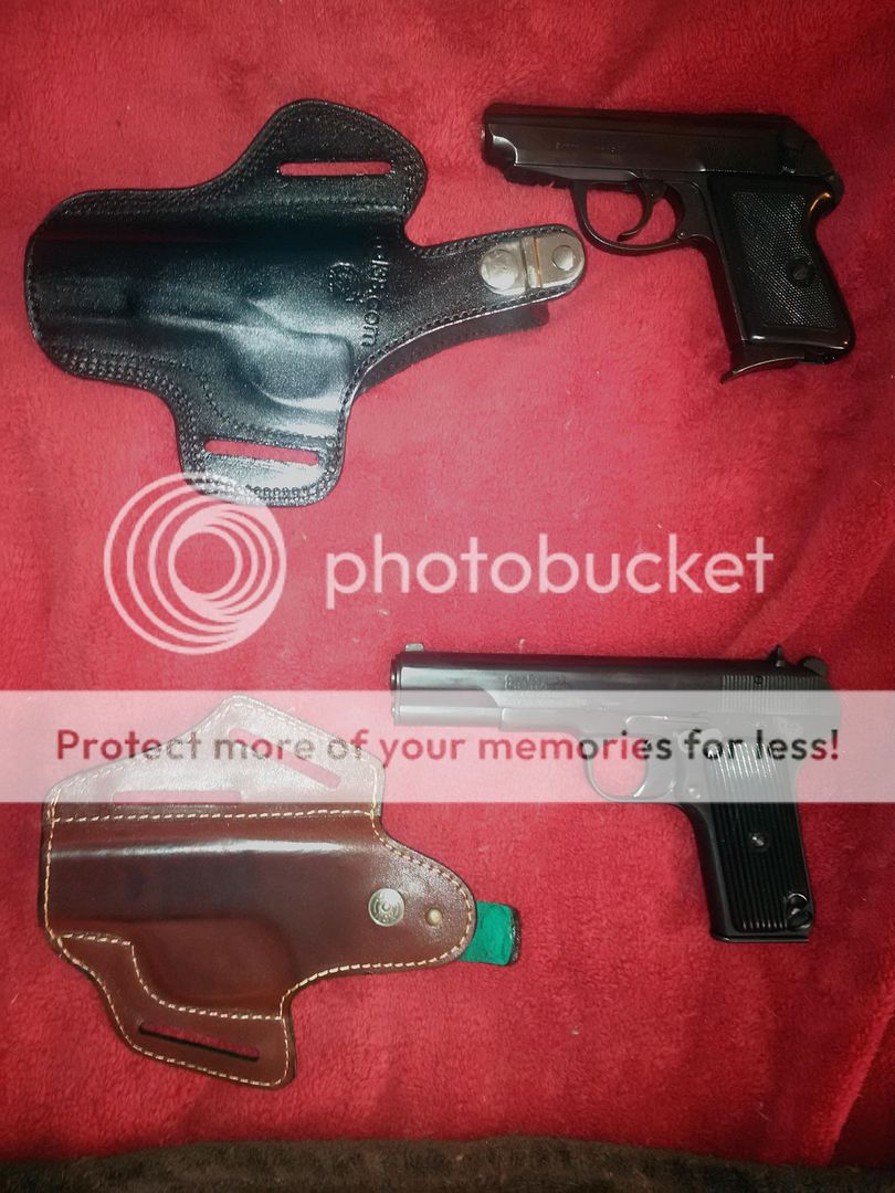

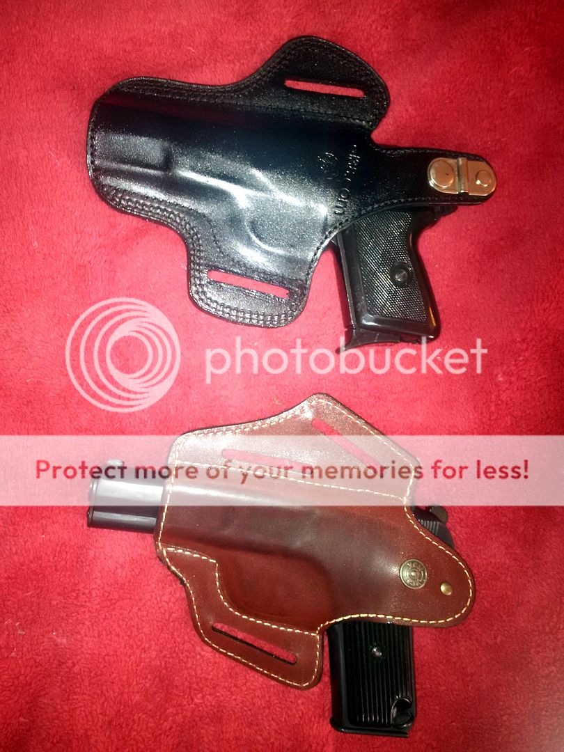

It's probably best to carry with the hammer unobstructed. Do consider that this gun was carried by police and military for years without too many problems. Choose your holster carefully by being one made specifically for the gun, not a genetic one size sorta fits all item.
The other gun is a tokarev TT-C
