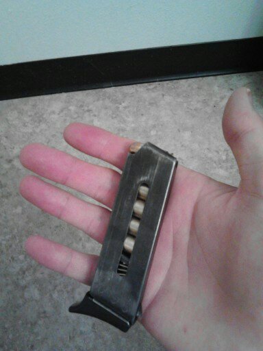

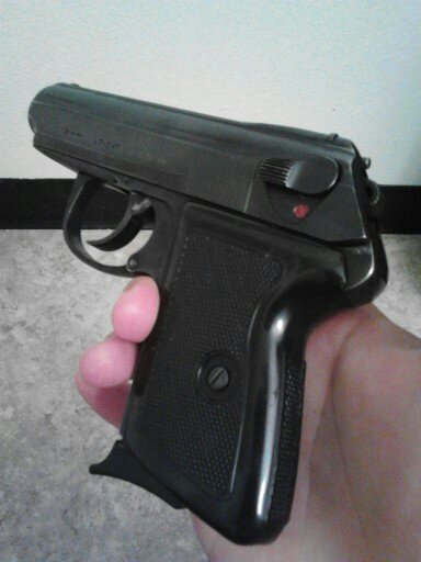

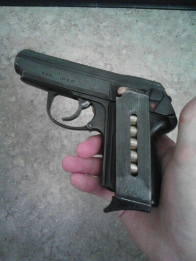

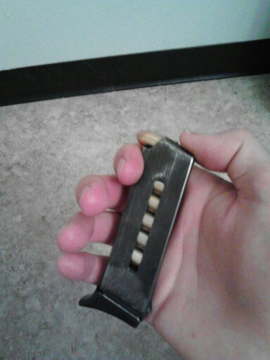

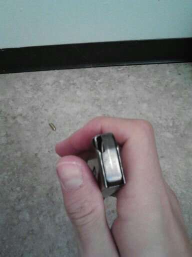

Hi all, I successfully increased the magazine capacity to feed and function flawlessly with 7 rounds and 1 in the chamber. Ill post up a youtube video as soon as I can find a camera.
The follower needs to be cut down roughly 2 mm. The spring needs to be cut 2 rungs and the gun at this point will run 8 rounds no problem ( that's 7 mag 1 tube) in order for the slide catch to work after this mag modification the slide lever spring needs to be replaced with a weaker spring. The weaker slide catch spring will not interfere with the pistol function whatsoever and the magazine will feed as fast as you can pull the trigger.

- Follower is tight and pushing hard on the top of the mag
- 1378845395474.jpg (30.26 KiB) Viewed 56040 times
- Here is the standard 6 in the mag
- 1378845333087.jpg (32.13 KiB) Viewed 56040 times
- Here is the extra 7th round in a full mag
- 1378845326303.jpg (30.72 KiB) Viewed 56040 times
- 7 mag 1 in the chamber
- 1378845255040.jpg (37.18 KiB) Viewed 56040 times
- Totally sealed, tight and in line
- 1378845168431.jpg (33.84 KiB) Viewed 56040 times
