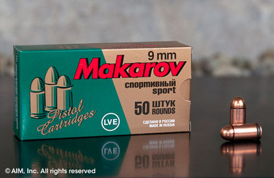

ive shot blazer with no problems however it seems to kick more to me than other ammo. brown and silver bear seem good, and despite some of the issues ive heard, i havent had a problem with PPU. i havent tried wolf yet and i don't think im going to try it.
the only problem ive had with any ammo was LVE and im not sure if it was the ammos fault. The ammo seems pretty dirty while shooting( but most mak stuff seems that way to me) and after about 200 rounds the bullets werent sliding completely into the chamber. i would have to give the slide a little nudge to get it all the way in. not every round, one out of 15-20. i think curly suggested really cleaning the chamber good and then clean it again, that fixed my problem. the ammo is coated with something to prevent rusting, and i think that was building up in the chamber. maybe give that a try.
good luck and let us know how things work out.
