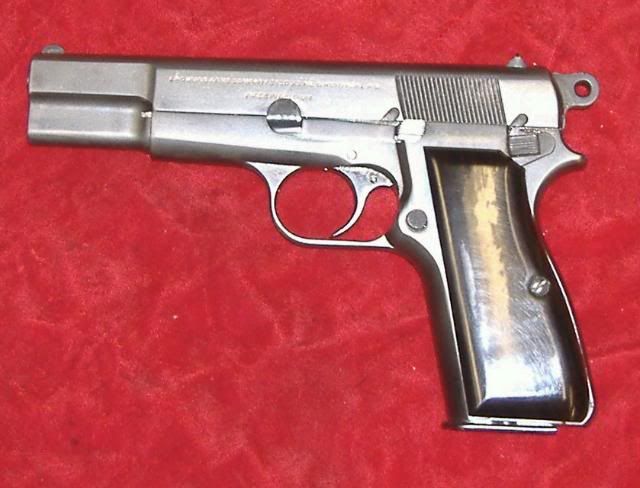

badgerjfr
don't know anything about ( CCR and their CPII ) I use http://www.elitecustomguns.com/index.htm just don't wait tell hunting season it will take forever
some other guns I had hard chromed
PA-63
BR-61
CZ-82
HP
