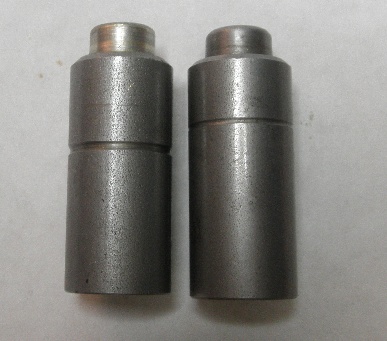

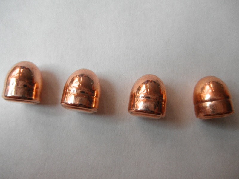

Here are two photos, the first is a sample of the crimped bullets pulled, to see if you agree that these looked crimped properly for Berry's Plated bullets. (all are crimped the same, but photo gives illusion that they are different). I wanted to crimp them a little extra due to expanding die going deeper, yet still not split the plating. To me, it looks about as heavy as I should go. OAL is .970. The second photo is the different expanding die inserts, which didn't seem to matter.

- Expander differences
- lee9mak_expander.jpg (46.13 KiB) Viewed 6501 times

I'm glad that you got your issues worked out!
I think that the amount of crimp that you apply is based on equal parts preference and firearm specific performance. If you're happy with the crimp, the bullet doesn't turn or wobble, and none of the lower rounds in the magazine have bullets come loose during operation, I'd say that you have found the right degree of crimp.
I apply as little crimp as possible to try to lessen the wear and tear on the brass so that I can get as many reloadings as possible out of them.
