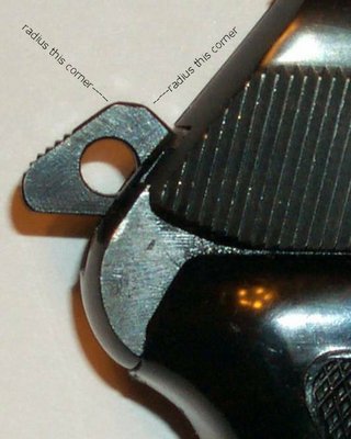

After firing about 20 rounds the safety catch started to get hard to turn after another 20 rounds I could no longer rotate the safety catch. I went out to the shop and disassembled the gun and found the hammer slide and safety catch were damaged. The hammer slide was severally peened, as you will see in juniustaylor’s post photo. I could not remove the safety catch so using a small machinist file I filed the slide at the safety catch just enough to remove the safety catch. After the safety catch was removed I used a Dremel on the slide removing just enough material so that the safety catch would slip into place without rubbing on the slide then I squared up the edges of the slide a little. I reassembled the gun without the recoil spring, while working the action back and forth I noticed the corners on the hammer where hitting at the area I just repaired. After determining exactly where the firing pin hits and the safety catch engages the hammer I decided I could radius the corners on the hammer slightly without affecting the working of the hammer. I filed the corners on the hammer (without removing the hammer) to create a small radius leaving about 1/8 inch of a flat spot between the two corners where the slide contacts the hammer. After finishing the repair I noticed the cocking action was smoother and everything else worked normally. It’s time to go to the range and do some test firing. After 25 rounds the safety catch worked properly and rotated smoothly. Another 25 rounds and everything worked just like it should. I am NOT a gunsmith use this information at your own risk remember its better to file off less material than more “patience is a virtue” and you need a lot of it when working on GUNS!!! See the excellent manual on this website for disassemble instructions.

Welcome Justafixer! That was a very informative & appreciated first post. I can see from the pictures in the thread where the hammer has peened/worn the area on the decocker & bottom of the slide, and I think your "fix" is a good idea. Anything you can do to smooth up the actions of these pistols will help them function better. They are very well made, but they are a military side arm, and as such can really benefit from some judicious polishing.

Just a quick note: the photo of the hammer I submitted was AFTER I filed the radius going any further would make it round. My camera won’t take as nice of a close up photo as juniustaylor does. I also noticed the hammer shown in the disassemble manual was quite rounded compared to mine.

Gotthcha, but just rounding the edges off like you did will not only smooth up the cocking action of the slide & hammer, but enable the slide to overcome the square hammer & force of the mainspring a bit easier. You are right when you say it doesn't take much metal removal, but just what you did will help a bunch.

The peening causes the safety catch to be hard to turn, or in my case I could no longer turn the safety catch making the safety usless. I have four P-64's they all had the same problems to varying degrees. See my post and photo it just take a little filing of the hammer to fix the problem, if your safety tuns freely you may not have to file the bottom of the slide or safety.

If the safety turns freely I wouldn't worry about filing the slide. Just file the hammer a little as it shows in the photo on my earlier post, you don't have to remove the hammer to file it.
