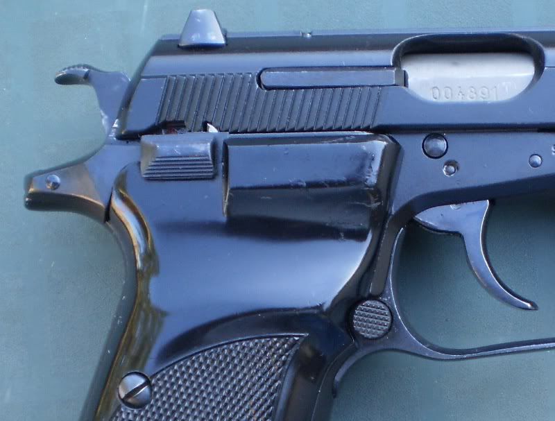

I was able to make some before and after pictures. I could have done a bit better on removing the scratches, but they're so minute now and I don't care. You can't even really tell they're there if you're not looking for them. The pictures almost don't even look like much improvement, but I'm happy with them.
LEFT GRIP BEFORE
LEFT GRIP AFTER
RIGHT GRIP BEFORE
RIGHT GRIP AFTER
LEFT GRIP BEFORE
LEFT GRIP AFTER
RIGHT GRIP BEFORE
RIGHT GRIP AFTER
