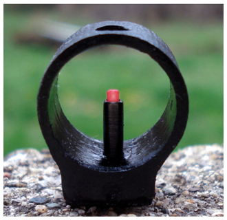

I am interested in the services of this guy... he makes adjustable front sights that you can either buy from him, or send in your front sight, and he modifies it to work. I know its something I can do myself, especially the "Po' Boy" model as that mod is on the internet. However, he sells a fiber optic version that looks dang cool.

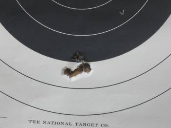

My favorite 7.62x54R load is:
Graf brass
46 grains of H4895
150 grain .311 Hornady SST (seated to the cannelure)
CCI 200 primer
Accurate as can be, and dropped 2 deer in their tracks from the PSL! Here's a pic of one of the groups...don't mind how low it is...had the scope set on "0"...
Note: Also accurate in 91/30 sniper!
