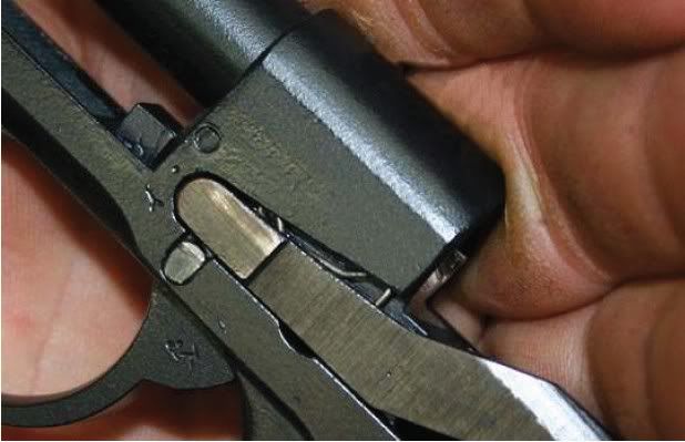

Ejector/Slide Lock lever contacts a spot on the follower. So, unless you messed the follower up, it should lock the slide. Well, it should lock it back if the magazine is fully inserted and then pull the slide back. When you remove the magazine, pull the slide back until it clicks and release, it will go forward.

Here's a picture.
-EDIT-
Here's a picture.

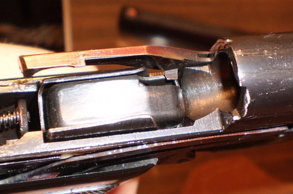

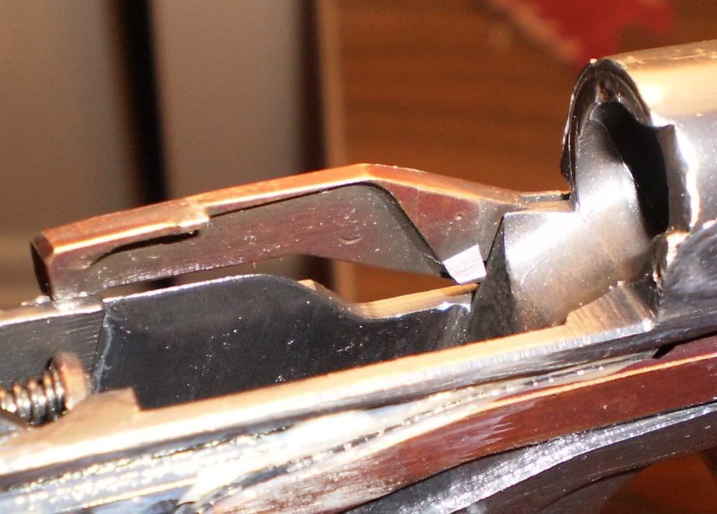

Anyway, you can see in these pictures where that little "tip" thing is on the slide stop lever and you can see in the second picture where it contacts the follower.
Make sure this little spring is in place
It sounds weird that your slide will lock back sometimes, but not consistently with that mag. You didn't modify that part of the follower where that tip contacts did you? Simply modifying the lips won't affect your slide locking back. Only things I could think of is if that tip were broke off, which it's not since it locks back with other mags. The second is if the mag spring was worn out and didn't have enough umph to allow the follower to lift the lever. Third is if you ground that ledge off that the tip contacts on the follower. Hope these pictures help some.

Hey, thanks for those great pics. No, I did not modify anything but the lips. I went and shot a clip again and it locked like it should have... kinda weird. Anyway, I am loving these guns! Thanks a bunch for your detailed help.
