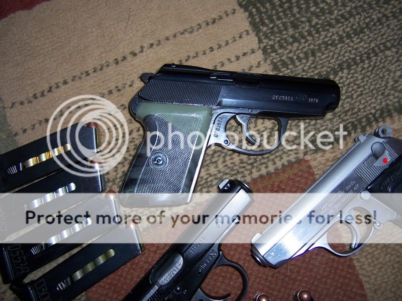

Mag oddity
Sapo, I see one of your mags (on the right) has the larger cut out, like my "good one". Your P-64 is a 1978, maybe something was different on earlier models?
I'm afraid you lost me on the seater plug thing.

You reload right? Your seater plug is putting a ring around the nose of your bullets. If you don't want the ring, do as I said. Take the seater plug out, if it's an RCBS it unscrews, same for a Lee. Use it like a cookie cutter on some felt or one of the foam ear plugs. Not the whole ear plug, about a 1/4 of it will do. Take the plug you just cut and glue it to the nose of your bullet seater plug. Sometimes the bullet profile in the plugs doesn't exactly match the profile of the bullets your reloading and you get the ring around them. Some guys use JB Weld. I didn't have any. The cheap-o foam ear plugs you get from the range work just as good. Actually mine is a 1975 model.
