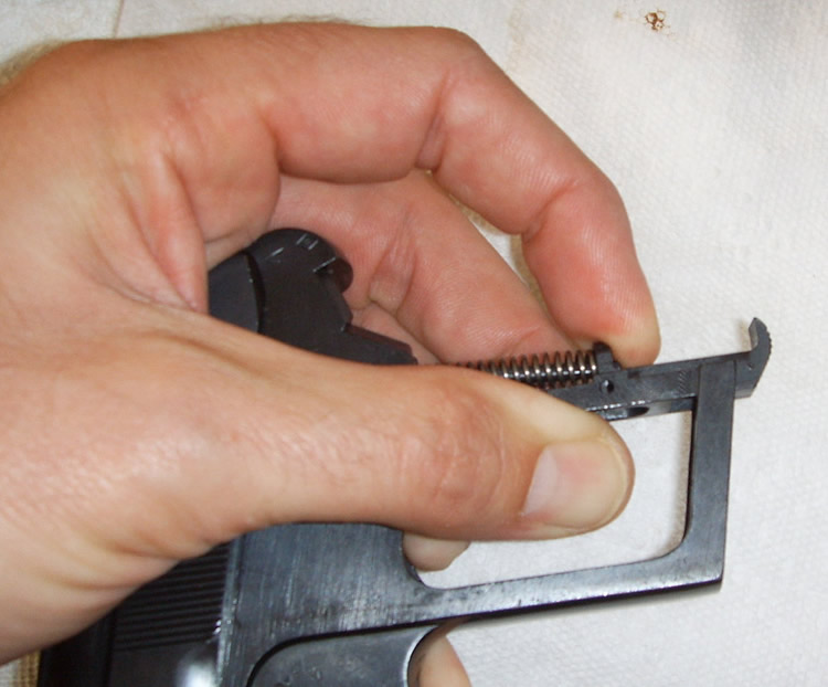

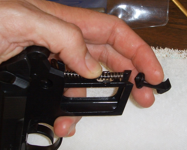

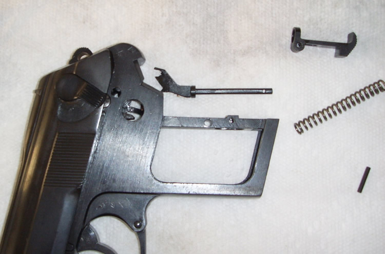

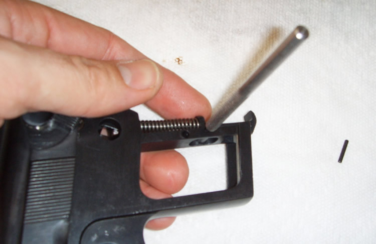

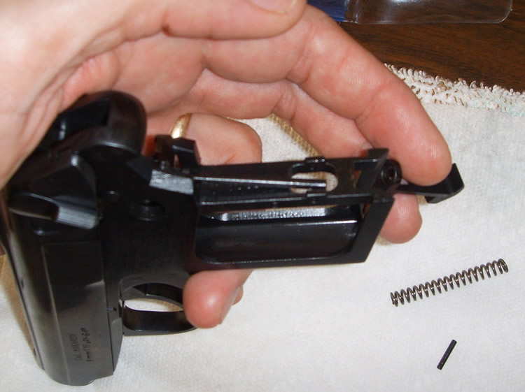

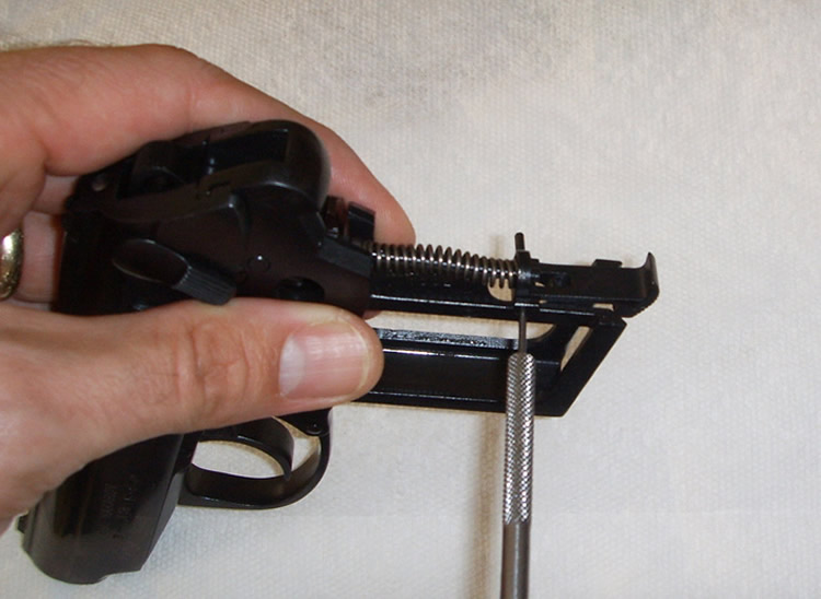

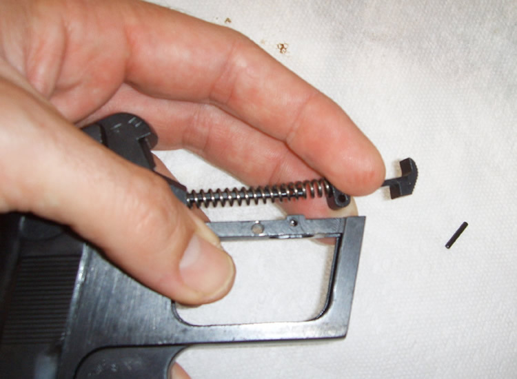

Replacing the mainspring (for lighter trigger pull)
0. Put on your safety glasses ... you are working with compressed springs here so don't be foolish!
1. Remove the magazine and make sure that the pistol is unloaded.
2. Recheck to make sure that the pistol is really unloaded.
3. Lower the hammer to take tension off of the mainspring
4. Find a screwdriver that fits the grip screw and remove the screw.
5. Gently pry the grips off of the frame ... the first time they come off, they can be a little tough ... just go slowly and all will be well ... you shouldn't need tools to get them to come off.
6. Find the pin about which the mag release pivots.
7. Take your 1/16" punch and push that pin out. If you don't have a set of punches, get a set of "Pistol Smith Punches" from MidwayUSA (part #482764) or some such outfit ... they are cheap (11.50 or less) and worth the price!
8. Wiggle the mag release until it comes out ... there is a little tension on the mainspring, but not too much.
9. When the mag release latch comes out, the mainspring will just slide off of its retaining pin.
10. Slide the new spring on and label the old one with a piece of tape so you don't lose track of it.
11. Put the mag release latch back in place (You can use the same punch used in step 7 to help align the holes) I've never needed 3 hands, but it does help to have something that you can push against.
12. Replace the mag release pivot pin
13. Replace the grips.
14. Replace the grip screw.
15. Admire the improvement in your P64 ...
None of the pins that I have seen have required a hammer to remove, but that doesn't mean that there aren't any out there.
Hope this helps ...
Saands

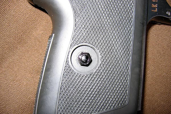

Grip nut replacement
I thought I would show a picture of a nut that I found at the hardware store, simple metric hex nuts (M3, .50 pitch) that works pretty good.
A blueing pen would be best, although I couldn't find mine so I used a black permanent marker. Not bad! They are approximately the same diameter and thickness as
the original nut, but of course that one is round. Not a bad idea to keep a few handy.
Stibnite
Materials: M3 metric hex nut .50 pitch @ Home Depot
the original nut, but of course that one is round. Not a bad idea to keep a few handy.Stibnite
