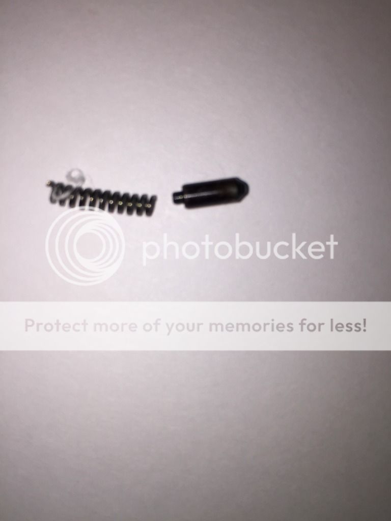

Weasel,I agree with you about the metallurgy,These pistols are a cruel form of engineering,Just look at the bottom of the slide lol.But I love this pistol.To answer your question Nick,I bought it used about two months ago.I had to have the chamber fixed where the extractor looks like it hit or someone before me abused it.I had it fixed and shot almost two boxes through it when the safety let loose.I was wondering about those members on here who have had safety selector issues whether they should have their's checked for excessive wear to the catch,jmo.Still learning about the pistol,I'd like to get a couple more of them.Does anyone else on here completely disassembled the slide? Those that have,Do you feel those springs for the safety detent seem weak?When I told mine apart,The detent I had to dig out of the slide.I'd like to hear other opinions on this,Thanks

The detent pin may have been sticky from cosmoline. When I got mine, the first thing I did was a complete disassembly and cleaning. I too, had to pull the detent pin out of the slide. Once I cleaned the parts completely, it went back in without a problem and moves freely. I did notice a change in the feel of the safety selector after the cleaning. You can now feel the detent pin engage as it should when using the safety selector.
Take a squeeze bottle and fill it with water that is near boiling. A few good squirts into the hole for the detent pin and it should be completely free of cosmoline.
Now when I clean it, I do not always disassemble the slide. If I use particularly dirty ammunition, it is going to get disassembled.

In my opinion,I think those detent springs are not strong enough,After reading all of the threads about safety selector switch issues,Plus the importance of cleaning all of the cosmoline out of the weapon.Those who have had issues with that I think in my opinion do the following; 1) check for excessive wear to the safety catch 2)if there is wear,Have a gunsmith check it out to make sure it's safe to shoot.Please don't get me wrong,I'm not trying to start a panic,But it's better to be safe than sorry.

Nick,I saw a pic of someone's detent and it looked like a lot of cosmoline in it.Also it is important not to dry fire these pistols,I know some people will disagree,I've never been a fan of dry firing any weapon,Something I've learned in the service.
