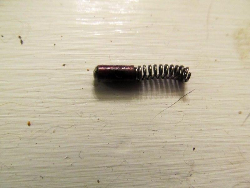

thank you all for your excellent help. I installed my new Wolff springs tonight and this is what I found. The internals were gummed up with tar. When I pulled the safety out, the firing pin shot out but not the the safety dentent/spring (item 32 & 33). I extracted the detent spring and found it to be kinked. Also, it appears that the cone is worn down on the detent pin. See the photo and see if you agree.
Thanks again!

Photo not showing.
The tar is probably dried up cosmoline or oil.
Had that on a 1942 Hi-power once that felt like sap thru out the whole pistol when I tore it down.
Keroseane cleaned it up in no time.

Let me tray again.

For $12 shipped you can get a pin and spring from the guy in Poland.
Peeps here have ordered parts from Poland no problem.
