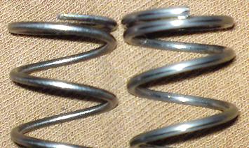

This is the same thing that happened to me with the Wolff 22lb recoil spring. If you look at your original recoil spring you will probably see that both ends are ground flat. The Wolff springs are not, this little bit of material is causing your slide to bind.
The way I got my slide off was simple. I just put on some tight fitting shooting gloves and they gave me the added grip I needed to get it off. Spent hours trying to get the darn thing off, but with the gloves on I got it right away. Good luck to you.
When you do get it off you will need to grind the ends of the recoil spring to match the ends of the spring that came with your gun. After that you will have no more problems.
Here is a pic of my original (L) vs the Wolff (R) recoil spring.

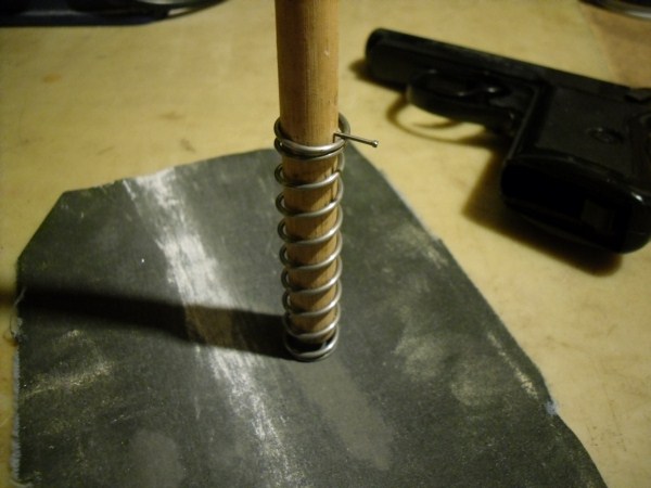

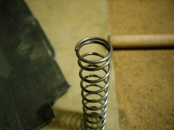

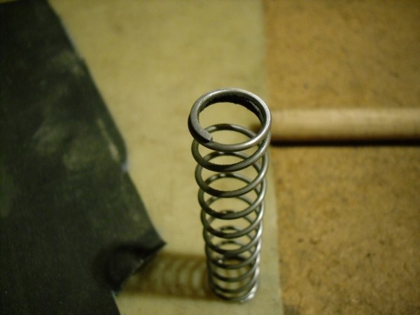

A cheap and easy solution to shorten the ends of the wolf recoil spring is to make a simple wooden sanding jig. All that is needed is a nail, emery cloth, and a small length of round doweling or square stock that can fit inside the recoil spring. I found out that if the spring protrudes beyond the dowel the tension when compressed does help to trim up the spring quickly and evenly. Here are a few photographs of the recoil spring before and after sanding and of the sanding jig.
Before sanding.
Before sanding.
After sanding.
After sanding.
Sanding jig.
Sanding jig.
