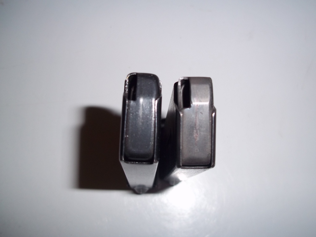

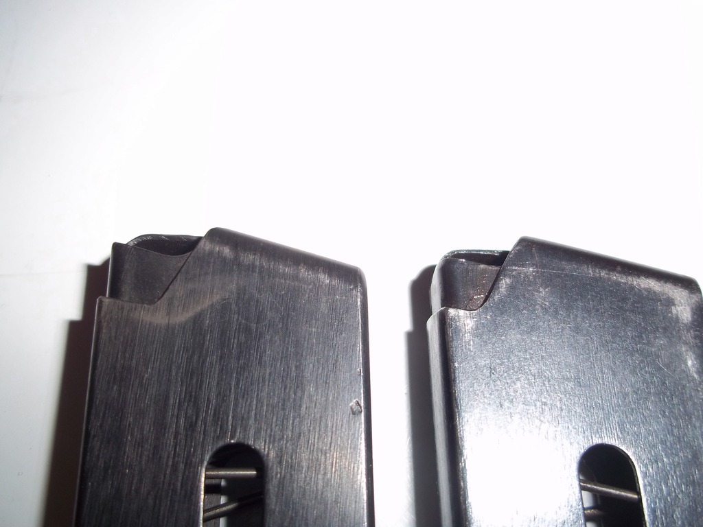

Glad for the site. Great information. I have a 1969 p-64. It has two magazines that are slightly different at the top. Both fit and autoload. I have not shot it. Will they both work? Don't want any catastrophic failures. Thank you,
Pic 2
Pic 2
Pic 1
Pic 1

That is a good question. Early mags have a larger cut out for the slide stop. The latter mags have approx. half the cut out.
Early mag---large
late mag----small
I am not sure when the change occured so can not say which is "correct" in a 1969, but they are interchangeable.

older mags have a larger cut out for the slide stop, I think they changed mags when they changed the hammer. older mags will work in a newer gun, newer mags will not work in a older gun. you have to reshape the newer ones, to work in a older gun.

What is different about the earlier pistols that makes the late magazines not work? I thought I read they would interchange. Thanks for that info and correction.

Thank you the answer to my question. I will not use the newer bigger one. Glad I asked.

just take a file and make the newer model the same as the older one. don't take much, I did it so my 1967 p64 and my 1976 can use the same mags . not hard to do.

Found these pics elsewhere with the "opinion" that the change took place with a small groups of other changes in 72 and that "old style" (short feed lips) works with all but "new style" (longer feed lips) only work with newer. Also note "what appears to be" a length difference in the notch in the follower. (may just be optical illusion based on different angle of mags in second pic). I have not confirmed but merely repeating. My experience is my 72 version with round hammer works well with the two "new style" mags I have. Maybe if someone has one of each of both old and new mags and pre / post 72 pistols, they can mix / swap and provide feedback here.
