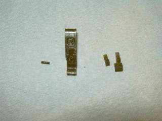

here are a couple of photos:
Re: p-83 double action problem
Posted: November 29th, 2012, 10:35 pm
by frisbee2421
and another frontal view photo:

That does not look like a fun thing to mess around with.
Posted: November 30th, 2012, 1:37 pm
by Weasel640
Wow that original one sure does look broken. Snapped right in half. You hammer does look a good bit more worn than mine. If it was a well used P-83 there is no telling how many thousands of rounds have been put through it. Small parts like that brake over time/use. Glad you identified the problem and are getting it fixed. I really like mine too.

very disappointed. i have tried 2 different vendors for a replacement spring that fits in the recess hole of the sear and the hammer. kind've pissed actually. tried buymilsurp.com i won't do business with that guy ever again. then i tried this guy in poland. he sent me the wrong size spring too. it would help me out greatly if someone could snap a photo of this spring and measure it for me. i am going to have to fabricate one from an ar15 trigger spring kit, being that the ar15 spring is the only one that fits in that hole. it is too long, so i will have to trim it down to size. any thoughts from my fellow members here?

weasel640, when you had your hammer out, could you see the spring that was in between the sear and the hammer on your pistol. i want to make sure that there is one there.

frisbee2421 wrote:weasel640, when you had your hammer out, could you see the spring that was in between the sear and the hammer on your pistol. i want to make sure that there is one there.
Yes there was a spring in there. That sucks that it's taking this long to not get the right parts. You can see in my pics how at rest the hammer ratchet/Hammer Fly stays in the outward position. I'd use a punch in place of the hammer ratchet pin for testing/fitting. I'd start off eye balling where to trim by putting the spring in the hammer then inserting the punch through the hammer and have the ratchet on the punch but on the side so to see where the spring would line up. I'd give myself a little extra length of spring and slowly trim it down testing fit. You want it long enough to keep tension on the ratchet but not to much or to little. I think the spring is just longer than the thickness of the neck of the hammer.
Hope this helps.
Try to get some pics of the process you use. That way if you hit a snag we can help more. Also others can learn from it if they encounter the same problem.

Great News!
my p-83 is back in action, that is double action and single action. i located the spring i needed from a guy named marcin in poland. a bit pricey but i was willing to pay. if you guys ever have a need for parts this guy is worth the money. the bad news is that it required paying a gunsmith $50 to fit the parts. it was $50 well spent. i could have just left it as a single action pistol but it annoyed me. the gunsmith had to ream the pin hole to get the pin started. he said i would have never been able to get it just right and i believe him. i figured i would leave it to the professional. he said that the pin was a tight fit and wouldn't come out on its own. if you have any questions let me know.
