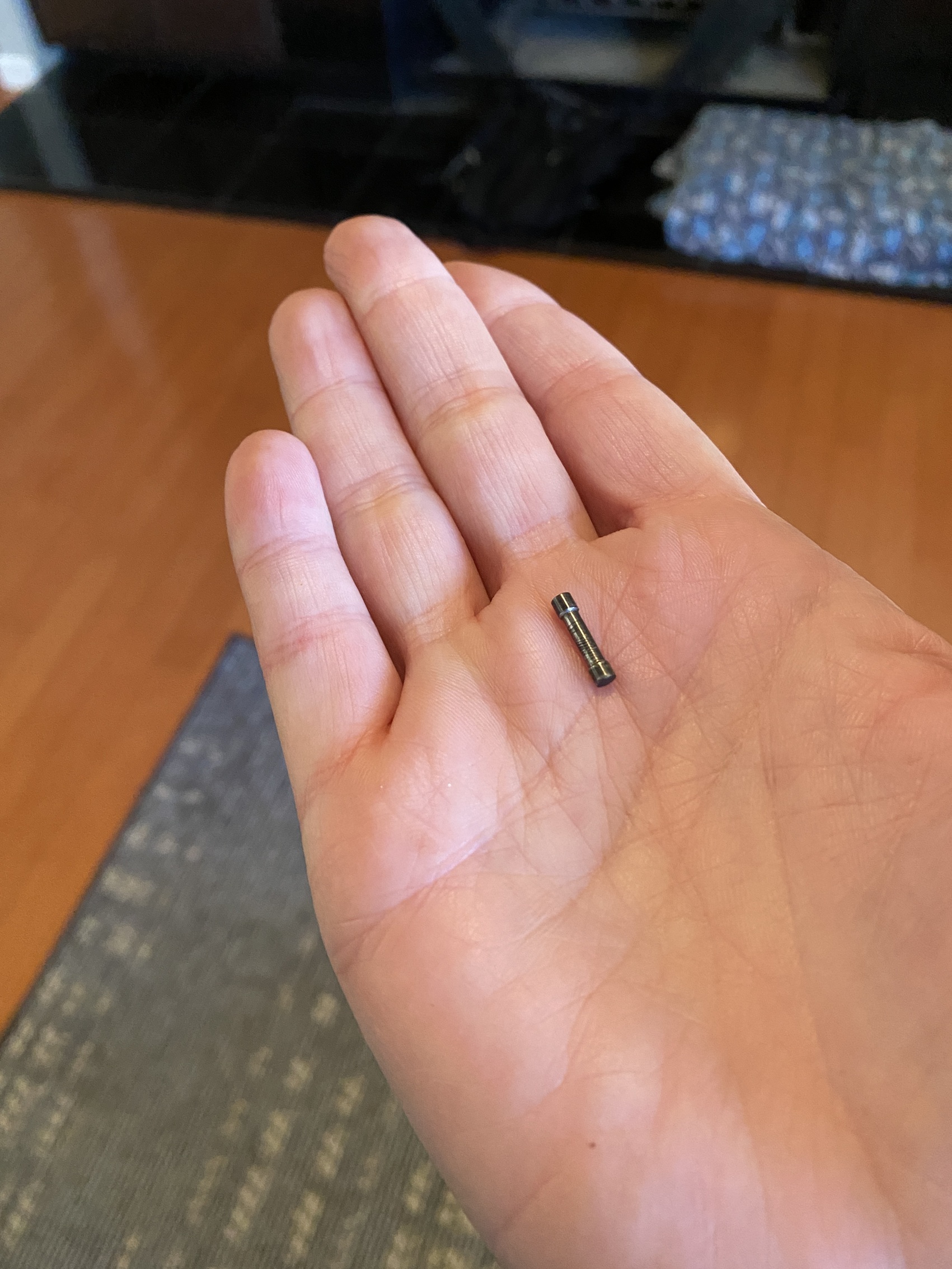

I've attached a photo of the pin that came loose from my 1971 P64. Dimensionally essentially the same as a new pin. I was surprised to find it in such good condition.

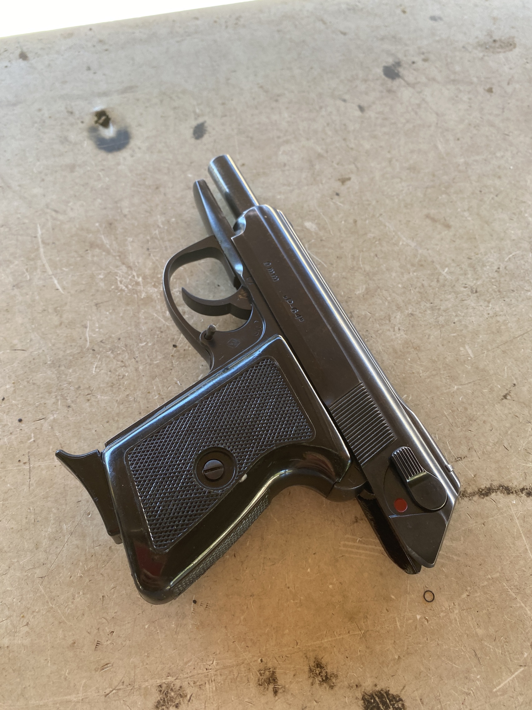

I've also attached a photo of the pistol when I first noticed the pin was falling out.
