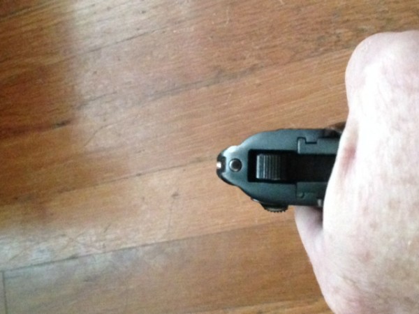

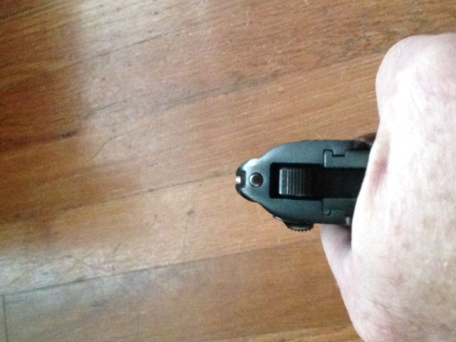

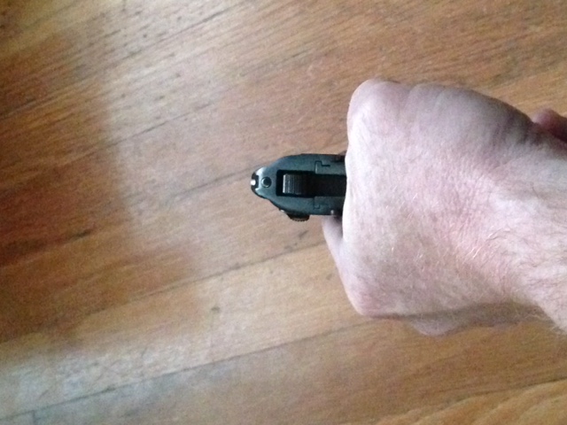

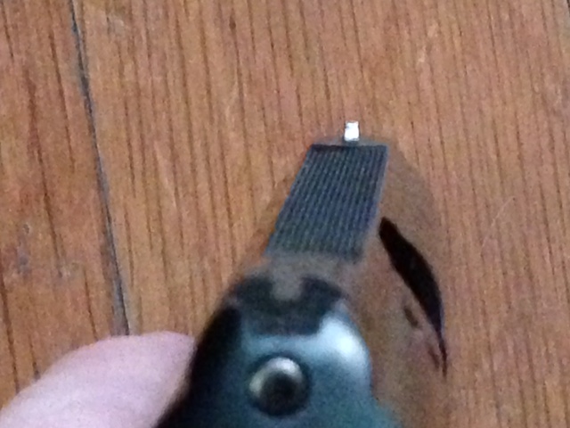

A couple views of the aluminum foil sight. Just applied a bit of epoxy to the sight with a toothpick, laid a piece of foil on the sight and burnished it down, trimmed up with an exact knife. The burnishing (I used one of the wood dowels I use to burnish leather edges) shined up the foil to almost chrome like, easy to find the sight in just about any lighting condition.
Re: Sights the old fashioned way...
Wow, unique answer to the problem of finding the front site on these pistols. I like it and may experiment with it a bit. I just picked up a Zastava M70 that has the same problem, small hard to see sights, this may be the answer. Thanks for the info. Keep us posted on how durable this is.
