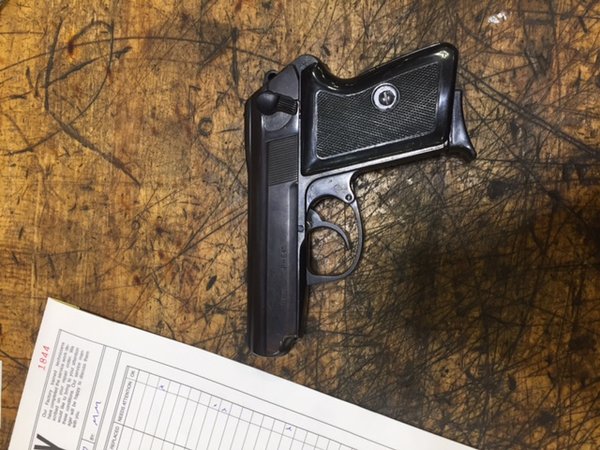

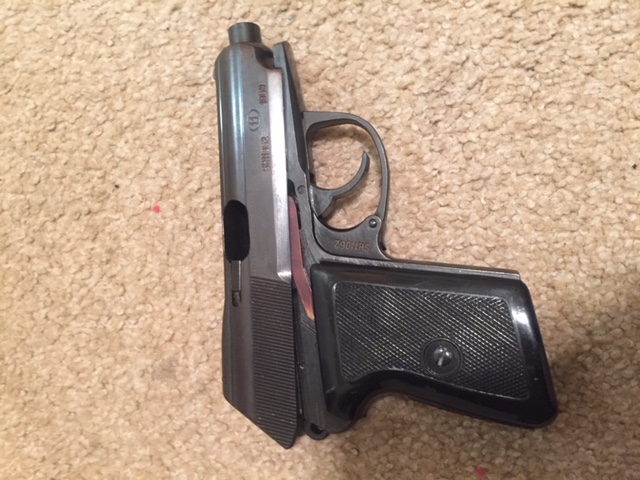

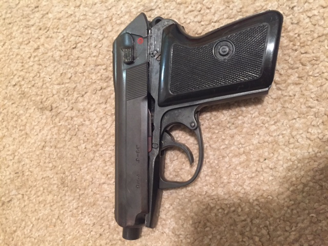

Hey everyone. Found this board while frantically searching the internet for help... hopefully you guys have some ideas. My safety was being a bit sticky so I removed the slide and disassembled the safetyto inspect it, found the problem and fixed it... but when I went to reassemble my greasy hands slipped off the slide and I somehow got the slide jammed. It looks as if the hold open is jammed upward and against the firing pin area... any ideas? Suggestions? Hit it with a hammer? Haha It's jammed up pretty solid. Won't slide back or forth at all.

I might try tapping it with a plastic hammer, but nothing steel. Even a block of wood but nothing hard. What you are trying to do is unstick not wedge it more. If you tap it one direction and it doesn't free it's self, try a different direction. If you hit it hard, you run the risk of springing the slide or damaging something. A light touch and you should be fine.

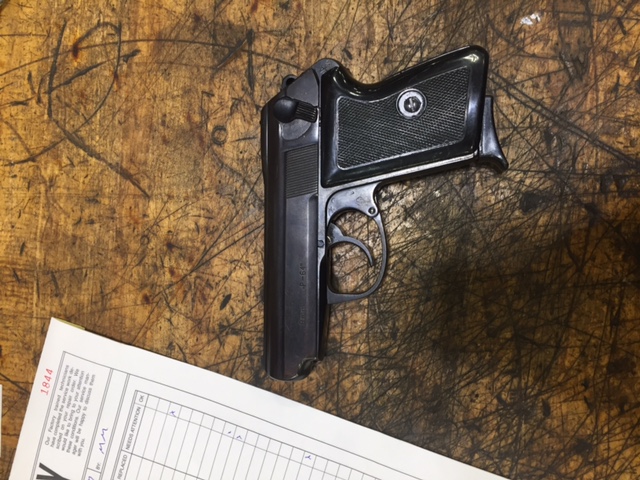

Thanks for all the suggestions. I took it into work this morning, clamped the slide in a vice (don't worry I used a towel to make sure I didn't damage it) and gave the frame a tap with a dead blow. Took the safety back out once the slide was unstuck and took a file too some edges to fix my sticky safety too.
